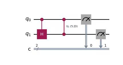

This function will generate a random circuit by randomly selecting gates from the set of standard gates in qiskit.circuit.library.standard_gates. For example:
from qiskit.circuit.random import random_circuit
circ = random_circuit(2, 2, measure=True)
circ.draw(output='mpl')
Circuit diagram output by the previous code.

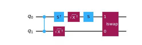

This function will generate a Clifford circuit by randomly selecting the chosen amount of Clifford gates from the set of standard gates in qiskit.circuit.library.standard_gates. For example:
from qiskit.circuit.random import random_clifford_circuit
circ = random_clifford_circuit(num_qubits=2, num_gates=6)
