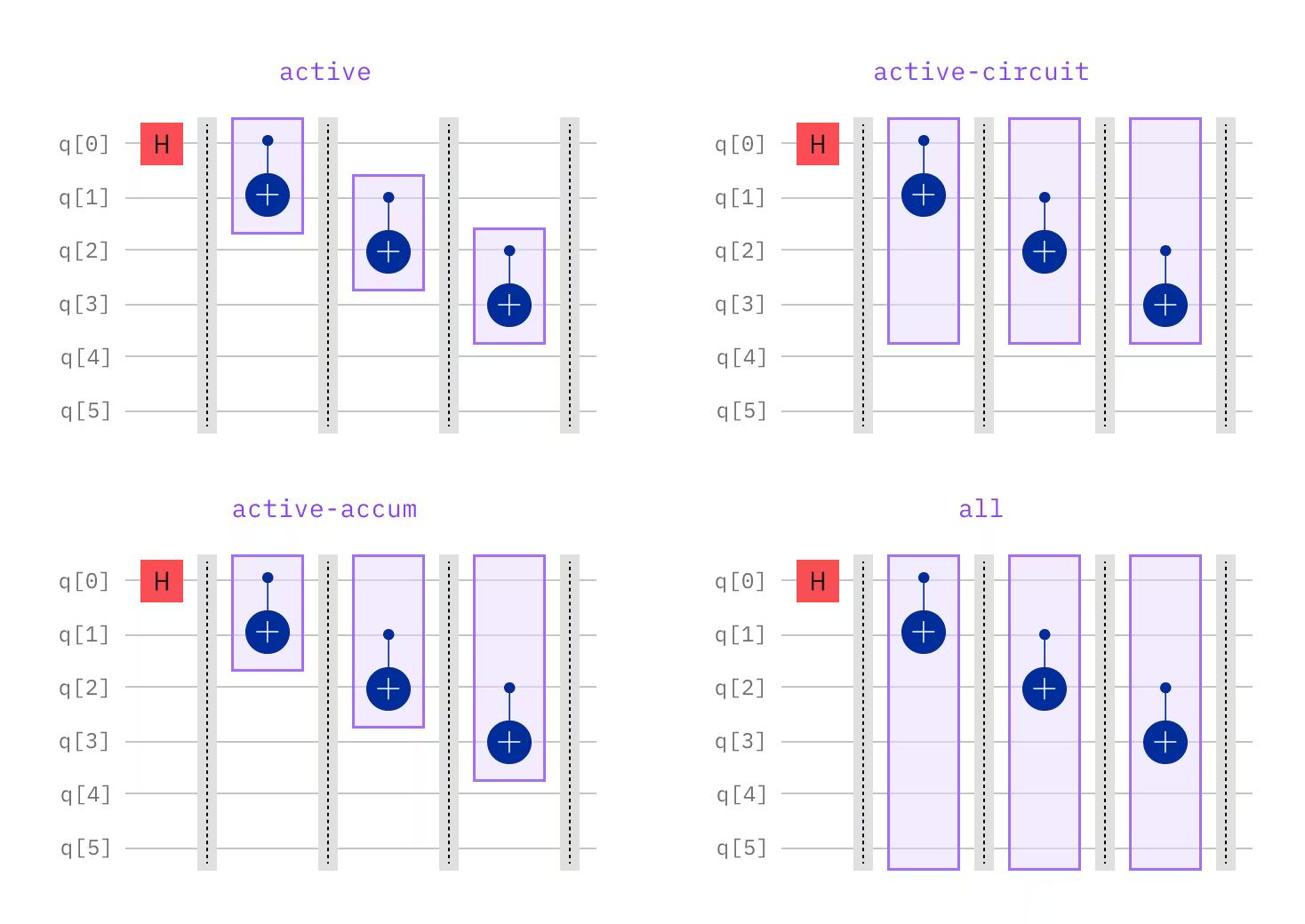

strategy
Type: UnsetType | Literal['active', 'active-accum', 'active-circuit', 'all']
Default value: Unset
Specify the strategy of twirling qubits in identified layers of 2-qubit twirled gates.
Allowed values are:
  • If "active" only the instruction qubits in each individual twirled layer will be twirled.
  • If "active-circuit" the union of all instruction qubits in the circuit will be twirled in each twirled layer.
  • If "active-accum" the union of instructions qubits in the circuit up to the current twirled layer will be twirled in each individual twirled layer.
  • If "all" all qubits in the input circuit will be twirled in each twirled layer.
Default: "active-accum".
Image illustrating the differences among twirling strategies. If "active", only instruction qubits in each layer will be twirled. If "active-circuit", all instruction qubits in the circuit will be twirled. If "active-accum", the union all instruction qubits in the circuit up to the current twirled layer will be twirled. Finally, if "all", all qubits in the input circuit will be twirled in each twirled layer.
