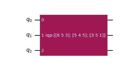

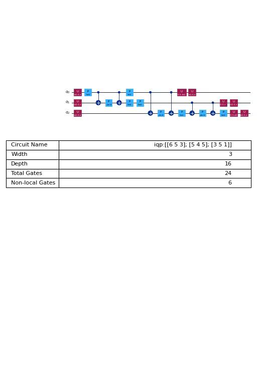

The circuit consists of a column of Hadamard gates, a column of powers of T gates, a sequence of powers of CS gates (up to n2n2\frac{n^2-n}{2} of them), and a final column of Hadamard gates, as introduced in [1].
The circuit is parameterized by an n x n interactions matrix. The powers of each T gate are given by the diagonal elements of the interactions matrix. The powers of the CS gates are given by the upper triangle of the interactions matrix.
Reference Circuit:
Diagram illustrating the previously described circuit.
Expanded Circuit:
