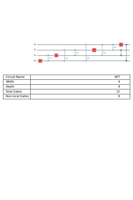

For 4 qubits, the circuit that implements this transformation is:

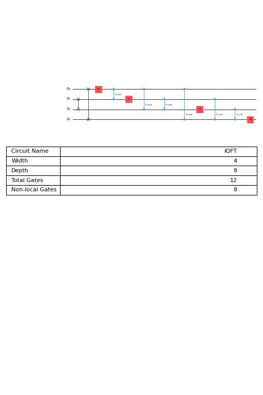

The inverse QFT can be obtained by calling the inverse method on this class. The respective circuit diagram is:

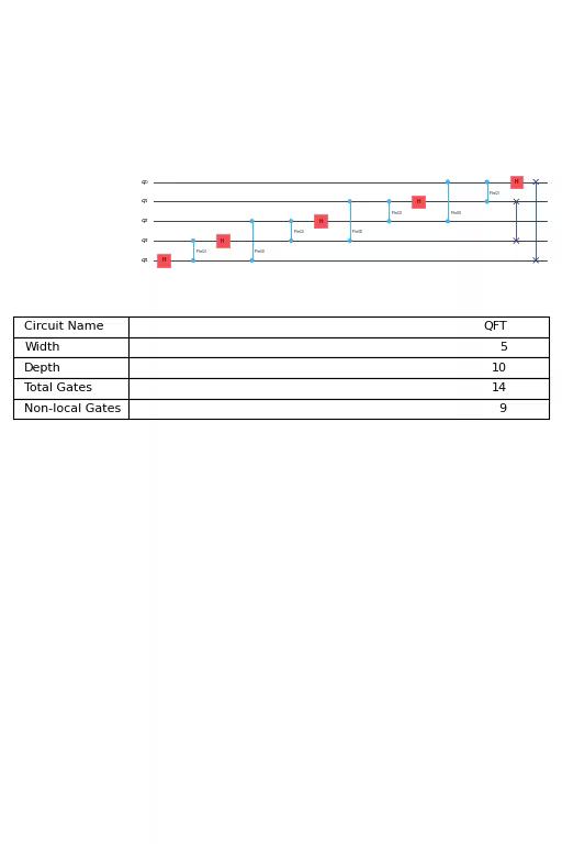

Here, this can be adjusted using the approximation_degree attribute: the smallest approximation_degree rotation angles are dropped from the QFT. For instance, a QFT on 5 qubits with approximation degree 2 yields (the barriers are dropped in this example):
