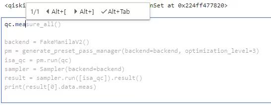

Additionally, after the assistant runs, you can use the buttons on the widget to cycle or accept the suggestion:
The popup pane with buttons is shown.
