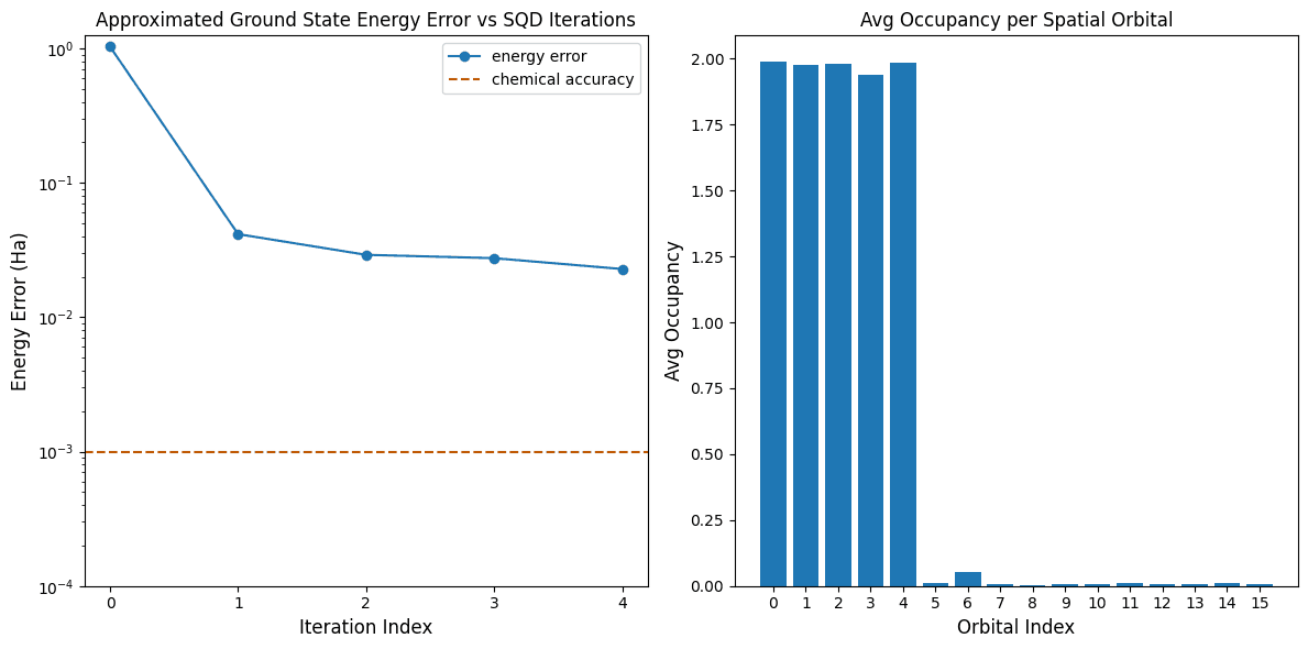

Visualize the results
Lastly, the results can be visualized by examining the approximated energy and average orbital occupancy at each iteration of the configuration recovery loop. The first plot shows that after a few iterations, the ground state energy is estimated to within approximately 27 mH (chemical accuracy is typically accepted to be 1 kcal/mol \approx 1.6 mH). Recall that this demonstration used pure noise, and that the ability to approximate the energy to this degree comes from prior knowledge about the molecule and its electronic structure.
The second plot shows the average occupancy of each spatial orbital after the final iteration. Notice that both the spin-up and spin-down electrons occupy the first five orbitals with high probability in the solutions.
# Chemical accuracy (+/- 1 milli-Hartree)
chem_accuracy = 0.001
exact_energy = -109.04667
# Data for energies plot
x1 = range(ITERATIONS)
min_e = [np.min(e) for e in energy_hist]
e_diff = [abs(e - exact_energy) for e in min_e]
yt1 = [1.0, 1e-1, 1e-2, 1e-3, 1e-4]
# Data for avg spatial orbital occupancy
y2 = occupancy_hist[-1][0] + occupancy_hist[-1][1]
x2 = range(len(y2))
fig, axs = plt.subplots(1, 2, figsize=(12, 6))
# Plot energies
axs[0].plot(x1, e_diff, label="energy error", marker="o")
axs[0].set_xticks(x1)
axs[0].set_xticklabels(x1)
axs[0].set_yticks(yt1)
axs[0].set_yticklabels(yt1)
axs[0].set_yscale("log")
axs[0].set_ylim(1e-4)
axs[0].axhline(
    y=chem_accuracy,
    color="#BF5700",
    linestyle="--",
    label="chemical accuracy",
axs[0].set_title("Approximated Ground State Energy Error vs SQD Iterations")
axs[0].set_xlabel("Iteration Index", fontdict={"fontsize": 12})
axs[0].set_ylabel("Energy Error (Ha)", fontdict={"fontsize": 12})
axs[0].legend()
# Plot orbital occupancy
axs[1].bar(x2, y2, width=0.8)
axs[1].set_xticks(x2)
axs[1].set_xticklabels(x2)
axs[1].set_title("Avg Occupancy per Spatial Orbital")
axs[1].set_xlabel("Orbital Index", fontdict={"fontsize": 12})
axs[1].set_ylabel("Avg Occupancy", fontdict={"fontsize": 12})
print(f"Exact energy: {exact_energy:.5f} Ha")
print(f"SQD energy: {min_e[-1]:.5f} Ha")
print(f"Absolute error: {e_diff[-1]:.5f} Ha")
plt.tight_layout()
plt.show()
Output:
Exact energy: -109.04667 Ha
SQD energy: -109.02383 Ha
Absolute error: 0.02284 Ha
