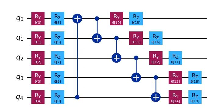

In this section, we will test the AI transpiler on the EfficientSU2 circuit, a widely used hardware-efficient ansatz. This circuit is particularly relevant for variational quantum algorithms (for example, VQE) and quantum machine-learning tasks, making it an ideal test case for assessing transpilation performance.
The EfficientSU2 circuit consists of alternating layers of single-qubit rotations and entangling gates like CNOTs. These layers enable flexible exploration of the quantum state space while keeping the gate depth manageable. By optimizing this circuit, we aim to reduce gate count, improve fidelity, and minimize noise. This makes it a strong candidate for testing the AI transpiler’s efficiency.
# For our transpilation, we will use a large circuit of 101 qubits
qc = EfficientSU2(101, entanglement="circular", reps=1).decompose()
# Draw a smaller version of the circuit to get a visual representation
qc_small = EfficientSU2(5, entanglement="circular", reps=1).decompose()
qc_small.draw(output="mpl")
Output:
Output of the previous code cell

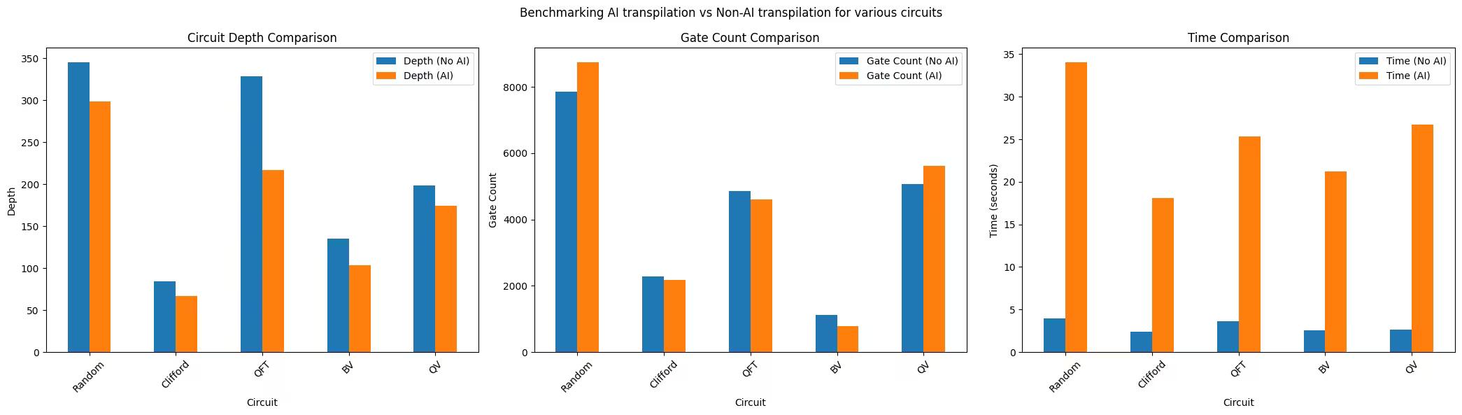

Part II. Analyze and benchmark the transpiled circuits
In this section, we will demonstrate how to analyze the transpiled circuit and benchmark it against the original version in more detail. We will focus on metrics such as circuit depth, gate count, and transpilation time to assess the effectiveness of the optimization. Additionally, we will discuss how the results may differ across various circuit types, offering insights into the broader performance of the transpiler across different scenarios.
# Circuits to benchmark
seed = 42
circuits = [
        "name": "Random",
        "qc": random_circuit(num_qubits=30, depth=10, seed=seed),
        "name": "Clifford",
        "qc": random_clifford_circuit(
            num_qubits=40, num_gates=200, seed=seed
    {"name": "QFT", "qc": QFT(20, do_swaps=False).decompose()},
        "name": "BV",
        "qc": create_bv_circuit(40),
    },  # Using the BV circuit function
    {"name": "QV", "qc": QuantumVolume(num_qubits=20, depth=10, seed=seed)},
results = []
# Run the transpilation for each circuit and store the results
for circuit in circuits:
    data = run_transpilation(circuit["qc"], no_ai_service, ai_service)
    print("Completed transpilation for", circuit["name"])
    results.append(
            "Circuit": circuit["name"],
            "Depth (No AI)": data["depth_no_ai"],
            "Gate Count (No AI)": data["gate_count_no_ai"],

Average percentage reduction for each metric. Positive are improvements, negative are degradations.
# Average reduction from non-AI to AI transpilation as a percentage
avg_reduction_depth = (
    (df["Depth (No AI)"] - df["Depth (AI)"]).mean()
    / df["Depth (No AI)"].mean()
    * 100
avg_reduction_gates = (
    (df["Gate Count (No AI)"] - df["Gate Count (AI)"]).mean()
    / df["Gate Count (No AI)"].mean()
    * 100
avg_reduction_time = (
    (df["Time (No AI)"] - df["Time (AI)"]).mean()
    / df["Time (No AI)"].mean()
    * 100
print(f"Average reduction in depth: {avg_reduction_depth:.2f}%")
print(f"Average reduction in gate count: {avg_reduction_gates:.2f}%")
print(f"Average reduction in transpilation time: {avg_reduction_time:.2f}%")
Output:
Average reduction in depth: 21.19%
Average reduction in gate count: -3.56%
Average reduction in transpilation time: -726.97%
fig, axs = plt.subplots(1, 3, figsize=(21, 6))
df.plot(x="Circuit", y=["Depth (No AI)", "Depth (AI)"], kind="bar", ax=axs[0])
axs[0].set_title("Circuit Depth Comparison")
axs[0].set_ylabel("Depth")
axs[0].set_xlabel("Circuit")
axs[0].tick_params(axis="x", rotation=45)
df.plot(
    x="Circuit",
    y=["Gate Count (No AI)", "Gate Count (AI)"],
    kind="bar",
    ax=axs[1],
axs[1].set_title("Gate Count Comparison")
axs[1].set_ylabel("Gate Count")
axs[1].set_xlabel("Circuit")
axs[1].tick_params(axis="x", rotation=45)
df.plot(x="Circuit", y=["Time (No AI)", "Time (AI)"], kind="bar", ax=axs[2])
axs[2].set_title("Time Comparison")
axs[2].set_ylabel("Time (seconds)")
axs[2].set_xlabel("Circuit")
axs[2].tick_params(axis="x", rotation=45)
fig.suptitle(
    "Benchmarking AI transpilation vs Non-AI transpilation for various circuits"
plt.tight_layout()
plt.show()
Output:
The AI transpiler's performance varies significantly based on the type of circuit being optimized. In some cases, it achieves notable reductions in circuit depth and gate count compared to the standard transpiler. However, these improvements often come with a substantial increase in runtime.
For certain types of circuits, the AI transpiler may yield slightly better results in terms of circuit depth but may also lead to an increase in gate count and a significant runtime penalty. These observations suggest that the AI transpiler's benefits are not uniform across all circuit types. Instead, its effectiveness depends on the specific characteristics of the circuit, making it more suitable for some use cases than others.

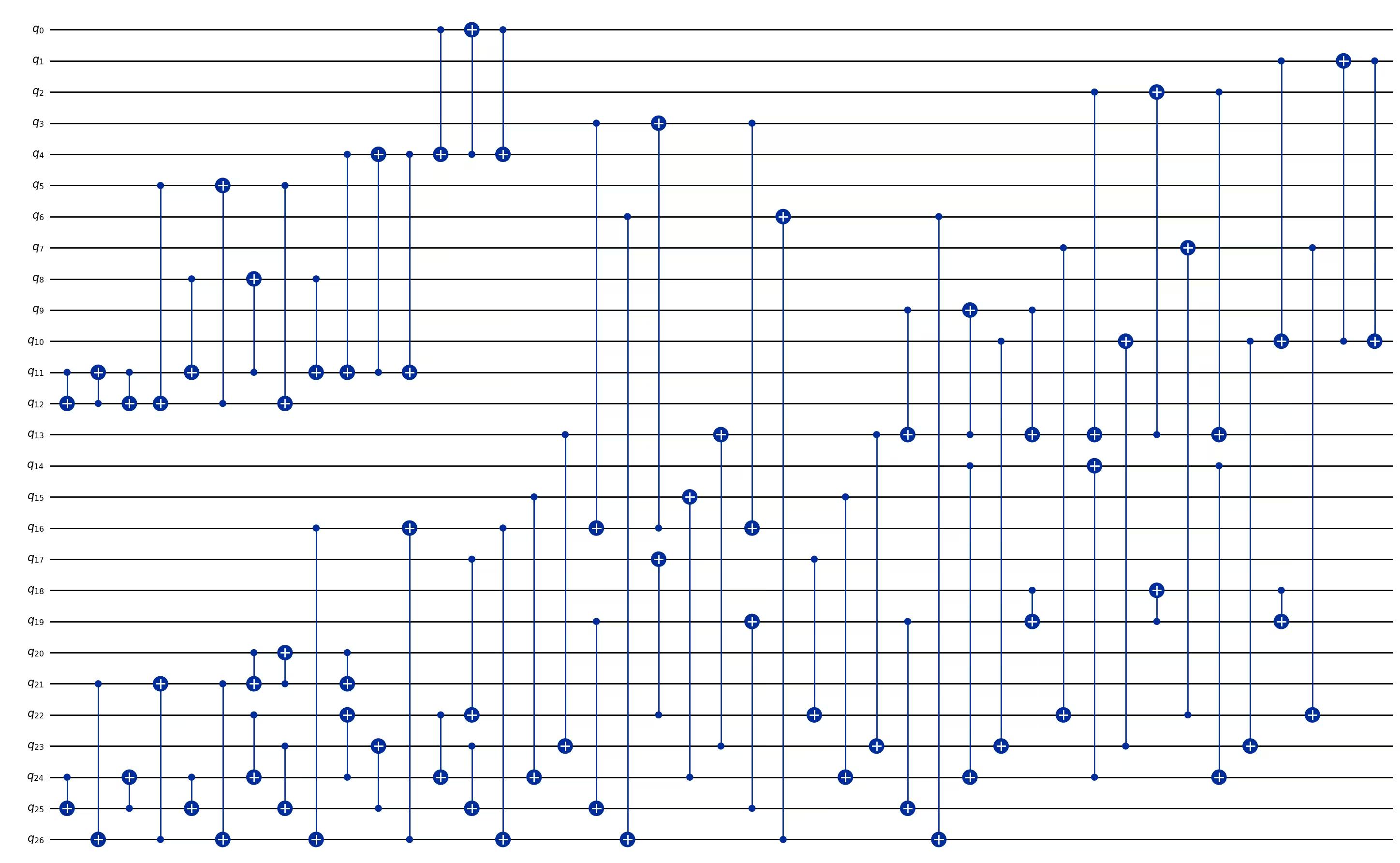

Part III. Explore AI-powered permutation network synthesis
Permutation networks are foundational in quantum computing, particularly for systems constrained by restricted topologies. These networks facilitate long-range interactions by dynamically swapping qubits to mimic all-to-all connectivity on hardware with limited connectivity. Such transformations are essential for implementing complex quantum algorithms on near-term devices, where interactions often span beyond nearest neighbors.
In this section, we highlight the synthesis of permutation networks as a compelling use case for the AI-powered transpiler in Qiskit. Specifically, the AIPermutationSynthesis pass leverages AI-driven optimization to generate efficient circuits for qubit permutation tasks. By contrast, generic synthesis approaches often struggle to balance gate count and circuit depth, especially in scenarios with dense qubit interactions or when attempting to achieve full connectivity.
We will walk through a Qiskit patterns example showcasing the synthesis of a permutation network to achieve all-to-all connectivity for a set of qubits. We will compare the performance of AIPermutationSynthesis against the standard synthesis methods in Qiskit. This example will demonstrate how the AI transpiler optimizes for lower circuit depth and gate count, highlighting its advantages in practical quantum workflows.
For more details about the AI-powered permutation synthesis in QTS, refer to the Qiskit API documentation.
Step 1: Map classical inputs to a quantum problem
To represent a classical permutation problem on a quantum computer, we start by defining the structure of the quantum circuits. For this example:
  1. Quantum circuit initialization: We allocate 27 qubits to match the backend we will use, which has 27 qubits.
  2. Apply permutations: We generate five random permutation patterns (pattern_1 through pattern_5) using a fixed seed (42) for reproducibility. Each permutation pattern is applied to a separate quantum circuit (qc_1 through qc_5).
  3. Circuit decomposition: Each permutation operation is decomposed into native gate sets compatible with the target quantum hardware. We analyze the depth and the number of two-qubit gates (nonlocal gates) for each decomposed circuit.
The results provide insight into the complexity of representing classical permutation problems on a quantum device, demonstrating the resource requirements for different permutation patterns.
# Parameters
width = 27
num_circuits = 5
seed = 42
# Set random seed
np.random.seed(seed)
# Function to generate permutation circuit
def generate_permutation_circuit(width, pattern):
    circuit = QuantumCircuit(width)
    circuit.append(
        Permutation(num_qubits=width, pattern=pattern),
        qargs=range(width),
    return circuit
# Generate random patterns and circuits
patterns = [
    np.random.permutation(width).tolist() for _ in range(num_circuits)
circuits = {
    f"qc_{i}": generate_permutation_circuit(width, pattern)
    for i, pattern in enumerate(patterns, start=1)
# Display one of the circuits
circuits["qc_1"].decompose(reps=3).draw(output="mpl", fold=-1)

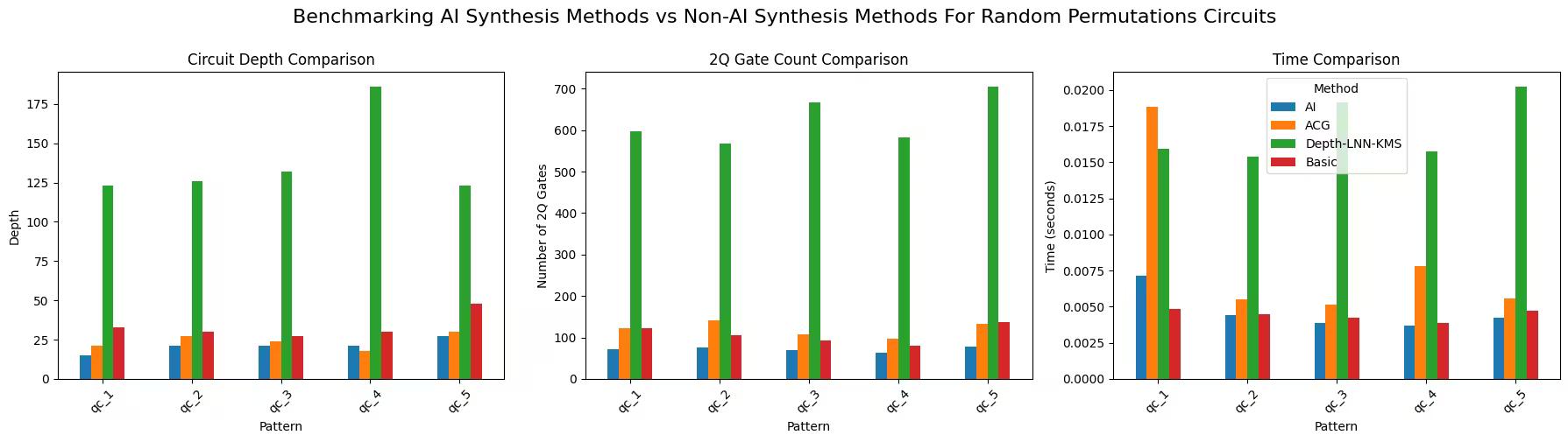

Plot the results to compare the performance of the AI synthesis passes against the generic synthesis methods.
methods = results_df["Method"].unique()
fig, axs = plt.subplots(1, 3, figsize=(18, 5))
# Pivot the DataFrame and reorder columns to ensure AI is first
pivot_depth = results_df.pivot(
    index="Pattern", columns="Method", values="Depth"
)[["AI", "ACG", "Depth-LNN-KMS", "Basic"]]
pivot_gates = results_df.pivot(
    index="Pattern", columns="Method", values="Gates(2q)"
pivot_time = results_df.pivot(
    index="Pattern", columns="Method", values="Time (s)"
pivot_depth.plot(kind="bar", ax=axs[0], legend=False)
axs[0].set_xlabel("Pattern")
pivot_gates.plot(kind="bar", ax=axs[1], legend=False)
axs[1].set_title("2Q Gate Count Comparison")
axs[1].set_ylabel("Number of 2Q Gates")
axs[1].set_xlabel("Pattern")
pivot_time.plot(
    kind="bar", ax=axs[2], legend=True, title="Legend"
)  # Show legend on the last plot
axs[2].set_xlabel("Pattern")
fig.suptitle(
    "Benchmarking AI Synthesis Methods vs Non-AI Synthesis Methods For Random Permutations Circuits",
    fontsize=16,
    y=1,
plt.tight_layout()
plt.show()
Output:
This graph highlights the individual results for each circuit (qc_1 to qc_5) across different synthesis methods:
  1. Circuit depth: The AI transpiler often achieves comparable or better depth optimizations than other methods, highlighting its ability to optimize depth efficiently for these permutation circuits.
  2. Two-qubit gate count: The AI transpiler also shows a substantial reduction in the number of two-qubit gates compared to other methods, indicating more efficient resource usage and improved circuit quality.
  3. Transpilation time: All methods, including the AI transpiler, run quickly at this scale. However, the AI method achieves its optimizations without introducing additional runtime overhead, making it highly practical.
While these results underscore the AI transpiler’s effectiveness for permutation circuits, it is important to note its limitations. The AI synthesis method is currently only available for certain coupling maps, which may restrict its broader applicability. This constraint should be considered when evaluating its usage in different scenarios.
Overall, the AI transpiler demonstrates promising improvements in depth and gate count optimization for these specific circuits while maintaining comparable transpilation times.
