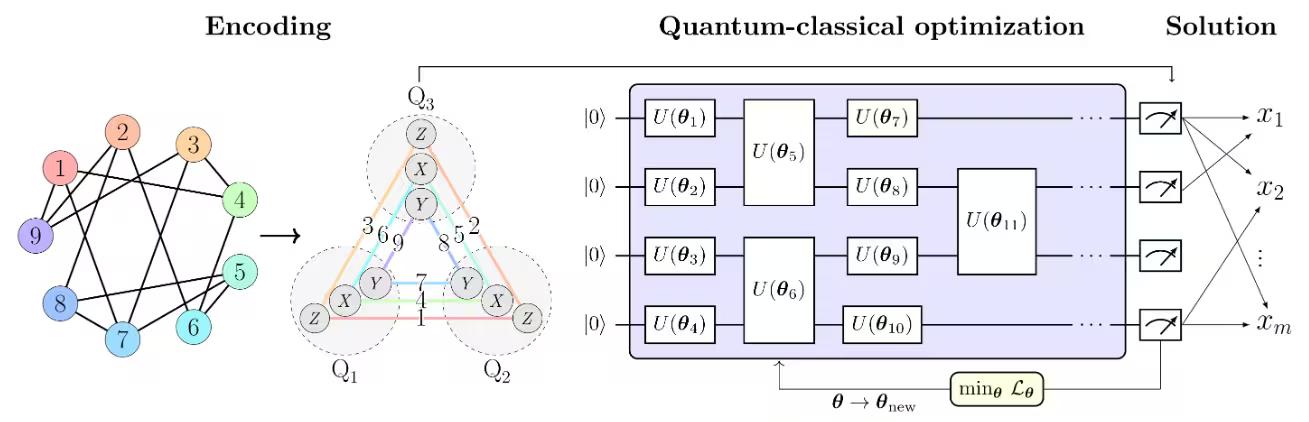

The PCE approach consists of three main steps, as illustrated in Figure 1 from [1] in below:
  1. Encoding the optimization problem into a Pauli correlation space.
  2. Solving the problem using a quantum-classical optimization solver.
  3. Decoding the solution back to the original optimization space. The PCE approach is adaptable to any quantum optimization solver capable of processing Pauli correlation matrices.
Overview of PCE.
In Figure 1 from [1], the max-cut problem is used as an example to illustrate the PCE approach. The max-cut problem with m=9m=9 nodes is encoded into a Pauli correlation space, representing the optimization problem as a correlation matrix — specifically, two-body Pauli-matrix correlations across n=3n=3 qubits (Q1,Q2,Q3)(Q_1, Q_2, Q_3). Node colors indicate the Pauli string used for each encoded node. For example, node 1, which corresponds to binary variable x1x_1, is encoded by the expectation value of Z1Z2I3Z_1 \otimes Z_2 \otimes I_3, while x8x_8 is encoded by I1Y2Y3I_1 \otimes Y_2 \otimes Y_3. This corresponds to compressing the problem's mm variables into n=O(m1/2) n = O(m^{1/2}) qubits. More broadly, kk -body correlations enable polynomial compressions of order kk, with k>1k>1. The chosen Pauli set comprises three subsets of mutually-commuting Pauli strings, allowing all mm correlations to be experimentally estimated with only three measurement settings.
A loss function L\mathcal{L} of Pauli expectation values that imitates the original max-cut objective function is constructed. The loss function is then optimized using a quantum-classical optimization solver, such as the Variational Quantum Eigensolver (VQE).
Once the optimization is complete, the solution is decoded back to the original optimization space, yielding the optimal max-cut solution.

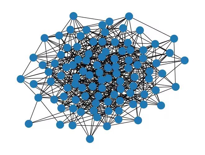

Let us first consider a random graph with 100 nodes.
num_nodes = 100  # Number of nodes in graph
seed = 42
graph = rx.undirected_gnp_random_graph(num_nodes, 0.1, seed=seed)
mpl_draw(graph)
Output:
Output of the previous code cell
