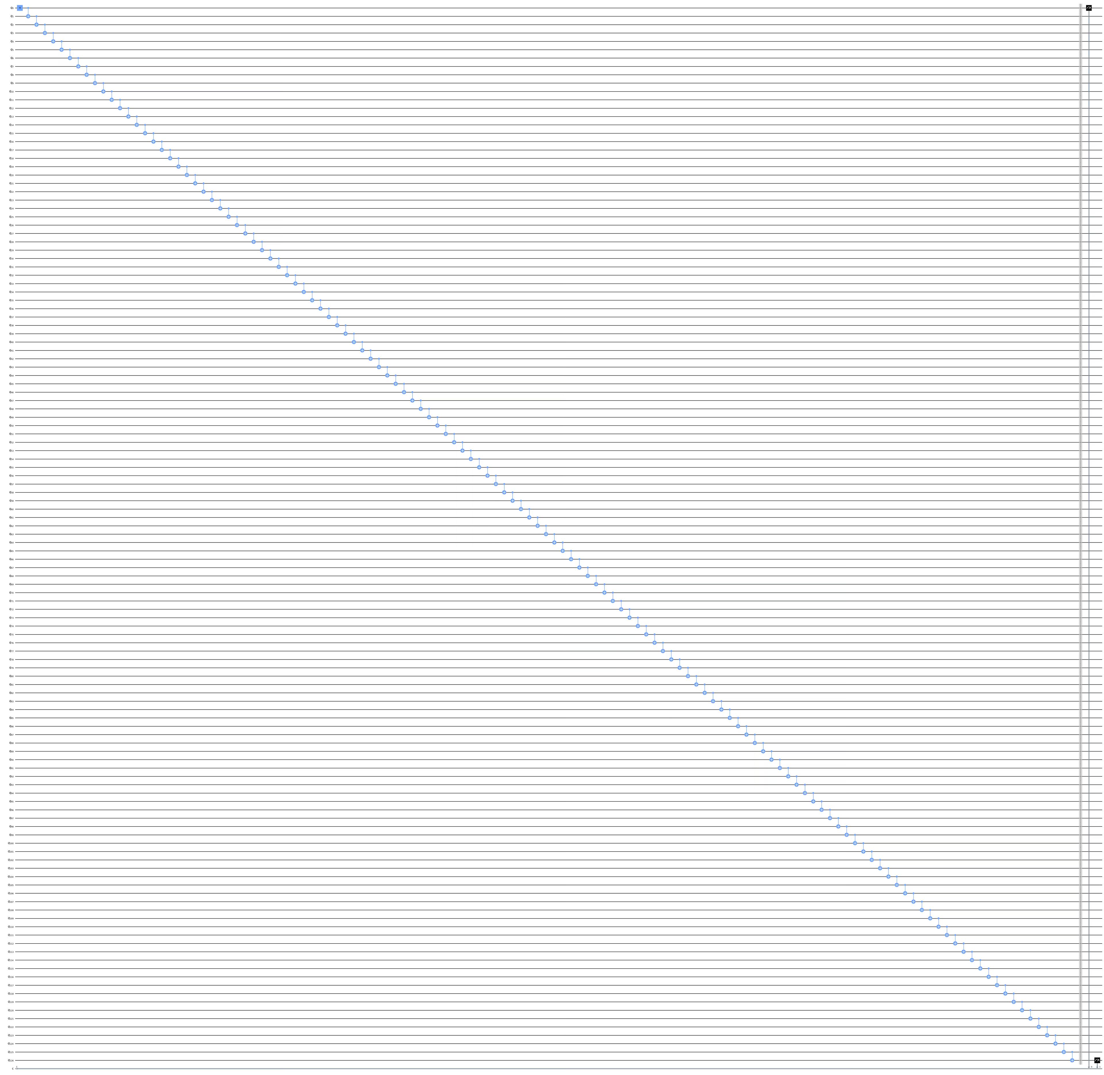

To benchmark the difference in performance, we consider a circuit that prepares a Bell state across a linear chain of varying length. The fidelity of the Bell state at the ends of the chain is measured.
ideal_dist = {"00": 0.5, "11": 0.5}
num_qubits_list = [10, 20, 30, 40, 50, 60, 70, 80, 90, 100, 110, 120, 127]
circuits = []
for num_qubits in num_qubits_list:
    circuit = QuantumCircuit(num_qubits, 2)
    circuit.h(0)
    for i in range(num_qubits - 1):
        circuit.cx(i, i + 1)
    circuit.barrier()
    circuit.measure(0, 0)
    circuit.measure(num_qubits - 1, 1)
    circuits.append(circuit)
circuits[-1].draw(output="mpl", style="clifford", fold=-1)

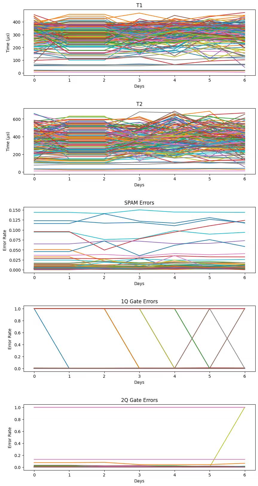

QPU properties over time
Looking at the reported QPU properties over time (we'll consider a single week below), we see how these can fluctuate on a scale of a single day. Small fluctuations can happen even within a day. In this scenario, the reported properties (updated once per day) will not accurately capture the current status of the QPU. Moreover, if a job is transpiled locally (using current reported properties) and submitted but executed only at a later time (minutes or days), it may run the risk of having used outdated properties for qubit selection in the transpilation step. This highlights the importance of having updated information about the QPU at execution time. First, let's retrieve the properties over a certain time range.
instruction_2q_name = "cz"  # set the name of the default 2q of the device
errors_list = []
for day_idx in range(10, 17):
    calibrations_time = datetime(
        year=2025, month=8, day=day_idx, hour=0, minute=0, second=0
    targer_hist = backend.target_history(datetime=calibrations_time)
    t1_dict, t2_dict = {}, {}
    for qubit in range(targer_hist.num_qubits):
        t1_dict[qubit] = targer_hist.qubit_properties[qubit].t1
        t2_dict[qubit] = targer_hist.qubit_properties[qubit].t2
    errors_dict = {
        "1q": targer_hist["sx"],
        "2q": targer_hist[f"{instruction_2q_name}"],
        "spam": targer_hist["measure"],
        "t1": t1_dict,
        "t2": t2_dict,
    errors_list.append(errors_dict)
Then, let's plot the values
fig, axs = plt.subplots(5, 1, figsize=(10, 20), sharex=False)
# Plot for T1 values
    t1s = []
    for errors_dict in errors_list:
        t1_dict = errors_dict["t1"]
        try:
            t1s.append(t1_dict[qubit] / 1e-6)
        except:
            print(f"missing t1 data for qubit {qubit}")
    axs[0].plot(t1s)
axs[0].set_title("T1")
axs[0].set_ylabel(r"Time ($\mu s$)")
axs[0].set_xlabel("Days")
# Plot for T2 values
    t2s = []
        t2_dict = errors_dict["t2"]
        try:
            t2s.append(t2_dict[qubit] / 1e-6)
        except:
            print(f"missing t2 data for qubit {qubit}")
    axs[1].plot(t2s)
axs[1].set_title("T2")
axs[1].set_ylabel(r"Time ($\mu s$)")
axs[1].set_xlabel("Days")
# Plot SPAM values
    spams = []
        spam_dict = errors_dict["spam"]
        spams.append(spam_dict[tuple([qubit])].error)
    axs[2].plot(spams)
axs[2].set_title("SPAM Errors")
axs[2].set_ylabel("Error Rate")
axs[2].set_xlabel("Days")
# Plot 1Q Gate Errors
    oneq_gates = []
        oneq_gate_dict = errors_dict["1q"]
        oneq_gates.append(oneq_gate_dict[tuple([qubit])].error)
    axs[3].plot(oneq_gates)
axs[3].set_title("1Q Gate Errors")
axs[3].set_ylabel("Error Rate")
axs[3].set_xlabel("Days")
# Plot 2Q Gate Errors
for pair in one_dir_coupling_map:
    twoq_gates = []
        twoq_gate_dict = errors_dict["2q"]
        twoq_gates.append(twoq_gate_dict[pair].error)
    axs[4].plot(twoq_gates)
axs[4].set_title("2Q Gate Errors")
axs[4].set_ylabel("Error Rate")
axs[4].set_xlabel("Days")
plt.subplots_adjust(hspace=0.5)
plt.show()
Output:
Output of the previous code cell
You can see that over several days some of the qubit properties can change considerably. This highlights the importance of having fresh information of the QPU status, to be able to select the best performing qubits for an experiment.

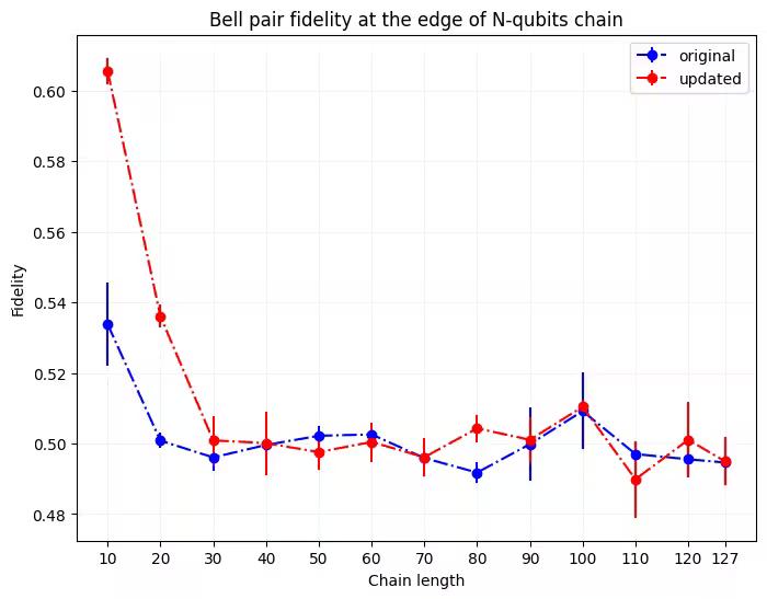

Step 4: Post-process and return result in desired classical format
Finally, let's compare the fidelity of the Bell state obtained in the two different settings:
  • original, that is with the default qubits chosen by the transpiler based on reported properties of the backend.
  • updated, that is with the qubits chosen based on updated properties of the backend after characterization experiments have run.
results = job_interleaved.result()
all_fidelity_list, all_fidelity_updated_list = [], []
for exp_idx in range(n_trials):
    fidelity_list, fidelity_updated_list = [], []
    for idx, num_qubits in enumerate(num_qubits_list):
        pub_result_original = results[
            2 * exp_idx * len(num_qubits_list) + 2 * idx
        pub_result_updated = results[
            2 * exp_idx * len(num_qubits_list) + 2 * idx + 1
        fid = hellinger_fidelity(
            ideal_dist, pub_result_original.data.c.get_counts()
        fidelity_list.append(fid)
        fid_up = hellinger_fidelity(
            ideal_dist, pub_result_updated.data.c.get_counts()
        fidelity_updated_list.append(fid_up)
    all_fidelity_list.append(fidelity_list)
    all_fidelity_updated_list.append(fidelity_updated_list)
plt.figure(figsize=(8, 6))
plt.errorbar(
    num_qubits_list,
    np.mean(all_fidelity_list, axis=0),
    yerr=np.std(all_fidelity_list, axis=0),
    fmt="o-.",
    label="original",
    color="b",
# plt.plot(num_qubits_list, fidelity_list, '-.')
plt.errorbar(
    num_qubits_list,
    np.mean(all_fidelity_updated_list, axis=0),
    yerr=np.std(all_fidelity_updated_list, axis=0),
    fmt="o-.",
    label="updated",
    color="r",
# plt.plot(num_qubits_list, fidelity_updated_list, '-.')
plt.xlabel("Chain length")
plt.xticks(num_qubits_list)
plt.ylabel("Fidelity")
plt.title("Bell pair fidelity at the edge of N-qubits chain")
plt.legend()
plt.grid(
    alpha=0.2,
    linestyle="-.",
plt.show()
Output:
Not all runs will show improvement in performance due to the real-time characterization - and with increasing chain length, and thus less freedom to choose physical qubits, the importance of updated device information becomes less substantial. However, it is good practice to collect fresh data on the device properties to understand its performance. Occasionally, transient two-level systems may affect the performance of some of the qubits. Real-time data can inform us when such events are happening and help us avoid experimental failures in such instances.
