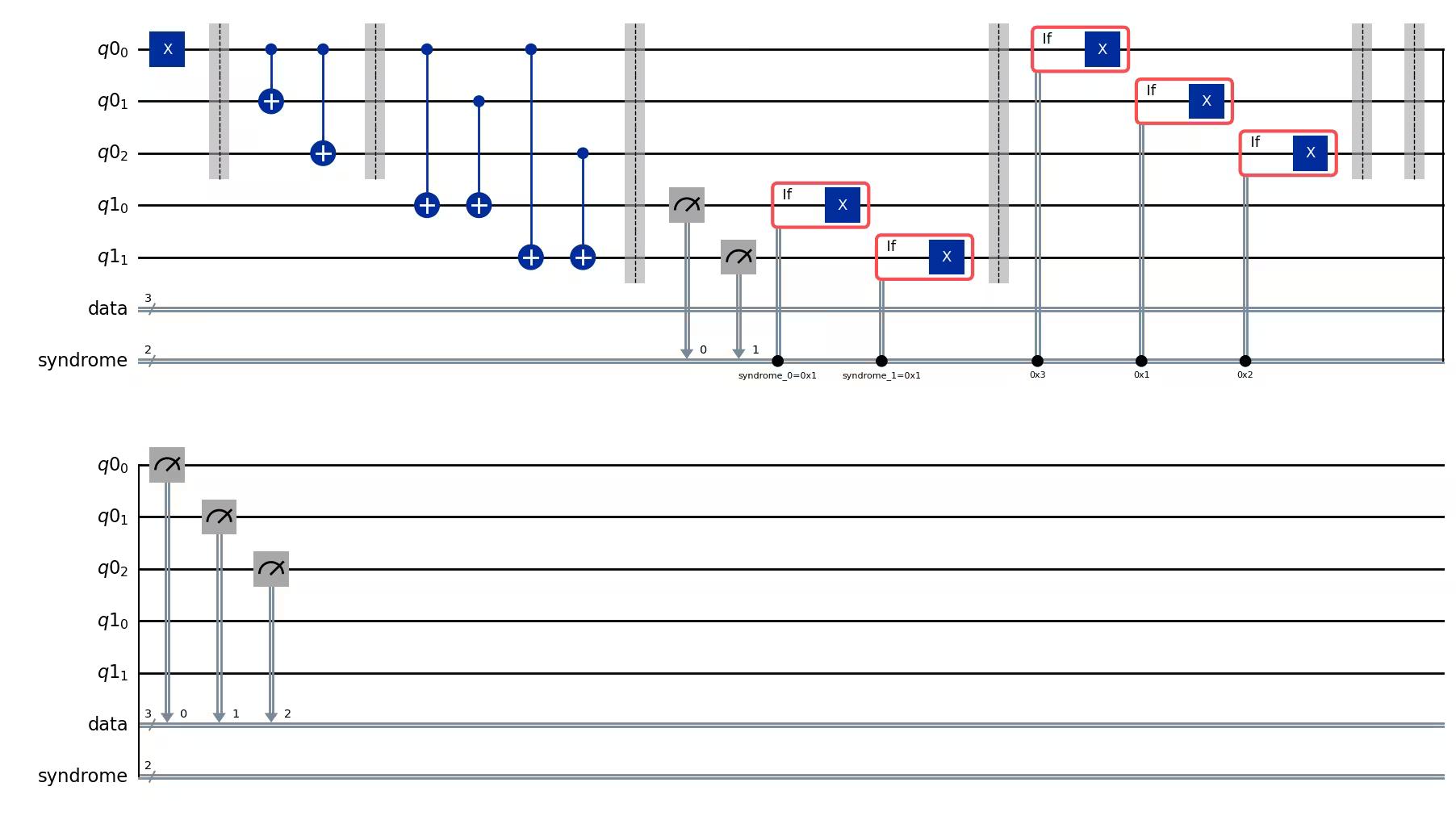

Build a bit-flip stabilizer circuit
The bit-flip code is among the simplest examples of a stabilizer code. It protects the state against a single bit-flip (X) error on any of the encoding qubits. Consider the action of bit-flip error XX, which maps 01|0\rangle \rightarrow |1\rangle and 10|1\rangle \rightarrow |0\rangle on any of our qubits, then we have ϵ={E0,E1,E2}={IIX,IXI,XII}\epsilon = \{E_0, E_1, E_2 \} = \{IIX, IXI, XII\}. The code requires five qubits: three are used to encode the protected state, and the remaining two are used as stabilizer measurement ancillas.

def build_qc():
    """Build a typical error correction circuit"""
    return QuantumCircuit(qreg_data, qreg_measure, creg_data, creg_syndrome)
def initialize_qubits(circuit: QuantumCircuit):
    """Initialize qubit to |1>"""
    circuit.x(qreg_data[0])
    circuit.barrier(qreg_data)
    return circuit
def encode_bit_flip(circuit, state, ancillas) -> QuantumCircuit:
    """Encode bit-flip. This is done by simply adding a cx"""
    for ancilla in ancillas:
        circuit.cx(state, ancilla)
    circuit.barrier(state, *ancillas)
    return circuit
def measure_syndrome_bit(circuit, qreg_data, qreg_measure, creg_measure):
    Measure the syndrome by measuring the parity.
    We reset our ancilla qubits after measuring the stabilizer
    so we can reuse them for repeated stabilizer measurements.
    Because we have already observed the state of the qubit,
    we can write the conditional reset protocol directly to
    avoid another round of qubit measurement if we used
    the `reset` instruction.
    circuit.cx(qreg_data[0], qreg_measure[0])
    circuit.cx(qreg_data[1], qreg_measure[0])
    circuit.cx(qreg_data[0], qreg_measure[1])
    circuit.cx(qreg_data[2], qreg_measure[1])
    circuit.barrier(*qreg_data, *qreg_measure)
    circuit.append(MidCircuitMeasure(), [qreg_measure[0]], [creg_measure[0]])
    circuit.append(MidCircuitMeasure(), [qreg_measure[1]], [creg_measure[1]])
    with circuit.if_test((creg_measure[0], 1)):
        circuit.x(qreg_measure[0])
    with circuit.if_test((creg_measure[1], 1)):
        circuit.x(qreg_measure[1])
    return circuit
def apply_correction_bit(circuit, qreg_data, creg_syndrome):
    """We can detect where an error occurred and correct our state"""
    with circuit.if_test((creg_syndrome, 3)):
    with circuit.if_test((creg_syndrome, 1)):
        circuit.x(qreg_data[1])
    with circuit.if_test((creg_syndrome, 2)):
        circuit.x(qreg_data[2])
    return circuit
def apply_final_readout(circuit, qreg_data, creg_data):
    """Read out the final measurements"""
    circuit.measure(qreg_data, creg_data)
    return circuit
def build_error_correction_sequence(apply_correction: bool) -> QuantumCircuit:
    circuit = build_qc()
    circuit = initialize_qubits(circuit)
    circuit = encode_bit_flip(circuit, state_data, ancillas_data)
    circuit = measure_syndrome_bit(
        circuit, qreg_data, qreg_measure, creg_syndrome
    if apply_correction:
        circuit = apply_correction_bit(circuit, qreg_data, creg_syndrome)
    circuit = apply_final_readout(circuit, qreg_data, creg_data)
    return circuit
circuit = build_error_correction_sequence(apply_correction=True)
circuit.draw(output="mpl", style="iqp", cregbundle=False)

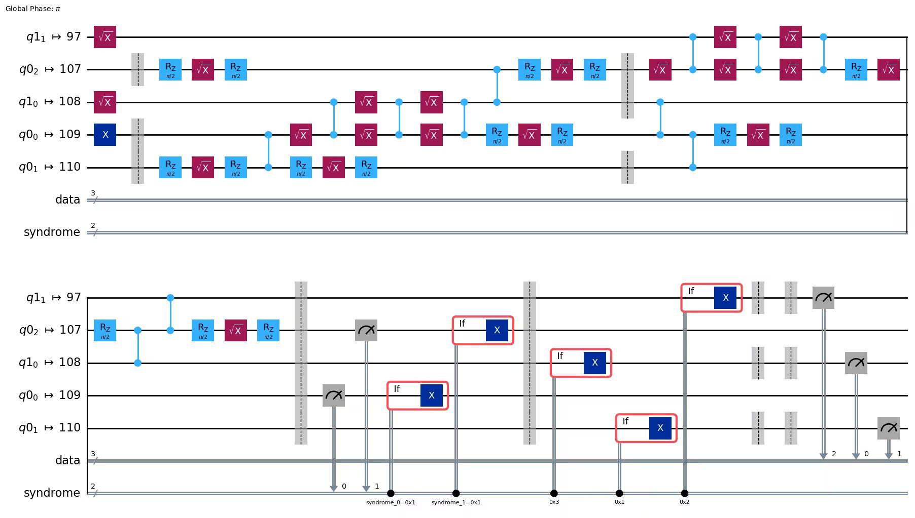

Step 2. Optimize the problem for quantum execution
To reduce the total job execution time, Qiskit primitives only accept circuits and observables that conforms to the instructions and connectivity supported by the target system (referred to as instruction set architecture (ISA) circuits and observables). Learn more about transpilation.
Generate ISA circuits
from qiskit.transpiler.preset_passmanagers import generate_preset_pass_manager
pm = generate_preset_pass_manager(backend=backend, optimization_level=1)
isa_circuit = pm.run(circuit)
isa_circuit.draw("mpl", style="iqp", idle_wires=False)
Output:
Output of the previous code cell Output of the previous code cell
no_correction_circuit = build_error_correction_sequence(
    apply_correction=False
isa_no_correction_circuit = pm.run(no_correction_circuit)
