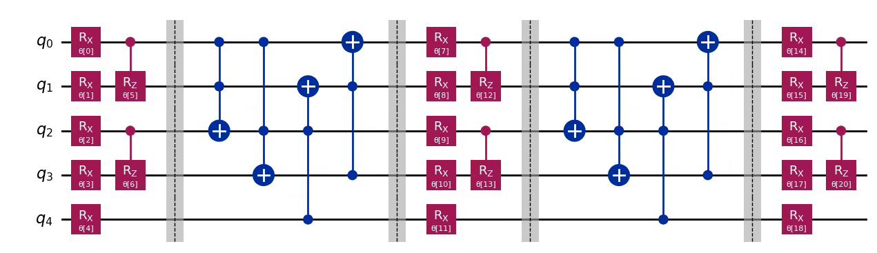

For example, let's create a five-qubit NLocal circuit with rotation blocks formed by RX and CRZ gates, entanglement blocks formed by Toffoli gates that act on qubits [0,1,2][0,1,2], [0,2,3][0,2,3], [4,2,1][4,2,1] and [3,1,0][3,1,0] and 22 repetitions of each layer.
from qiskit.circuit.library import NLocal, CCXGate, CRZGate, RXGate
from qiskit.circuit import Parameter
theta = Parameter("θ")
ansatz = NLocal(
    num_qubits=5,
    rotation_blocks=[RXGate(theta), CRZGate(theta)],
    entanglement_blocks=CCXGate(),
    entanglement=[[0, 1, 2], [0, 2, 3], [4, 2, 1], [3, 1, 0]],
    reps=2,
    insert_barriers=True,
ansatz.decompose().draw("mpl")
Output:
Output of the previous code cell
In the above example, the largest gate is the Toffoli gate, which acts on three qubits, making the circuit 33-local. The most commonly used type of NN-local circuits are 22-local circuits with single-qubit rotation gates and 22-qubit entanglement gates.

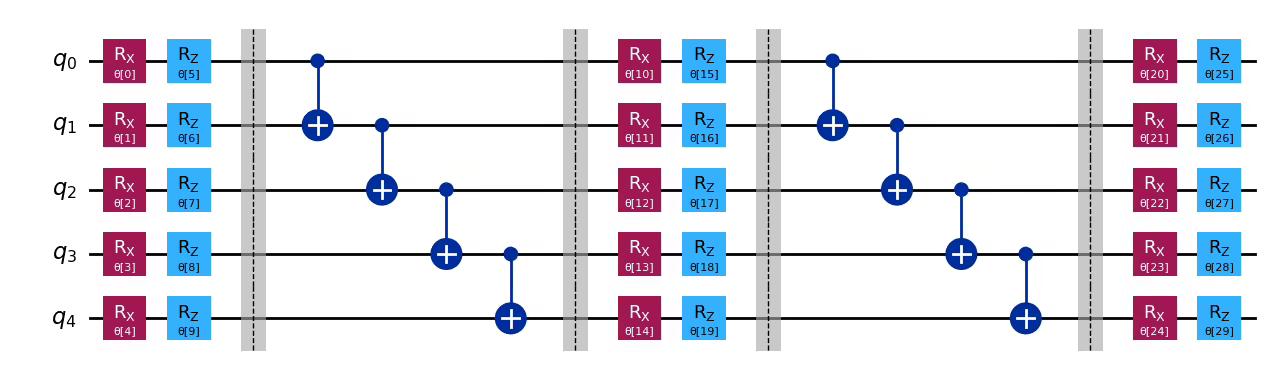

Let's create a 22-local circuit using Qiskit's TwoLocal class. The syntax is the same as NLocal, but there are some differences. For instance, most gates, such as RX, RZ, and CNOT, can be passed as strings without importing the gates or creating a Parameter instance.
from qiskit.circuit.library import TwoLocal
ansatz = TwoLocal(
    num_qubits=5,
    rotation_blocks=["rx", "rz"],
    entanglement_blocks="cx",
    entanglement="linear",
    reps=2,
Output:
In this case, we used the linear entanglement distribution, where each qubit is entangled with the next. To learn about other strategies, refer to the TwoLocal documentation.

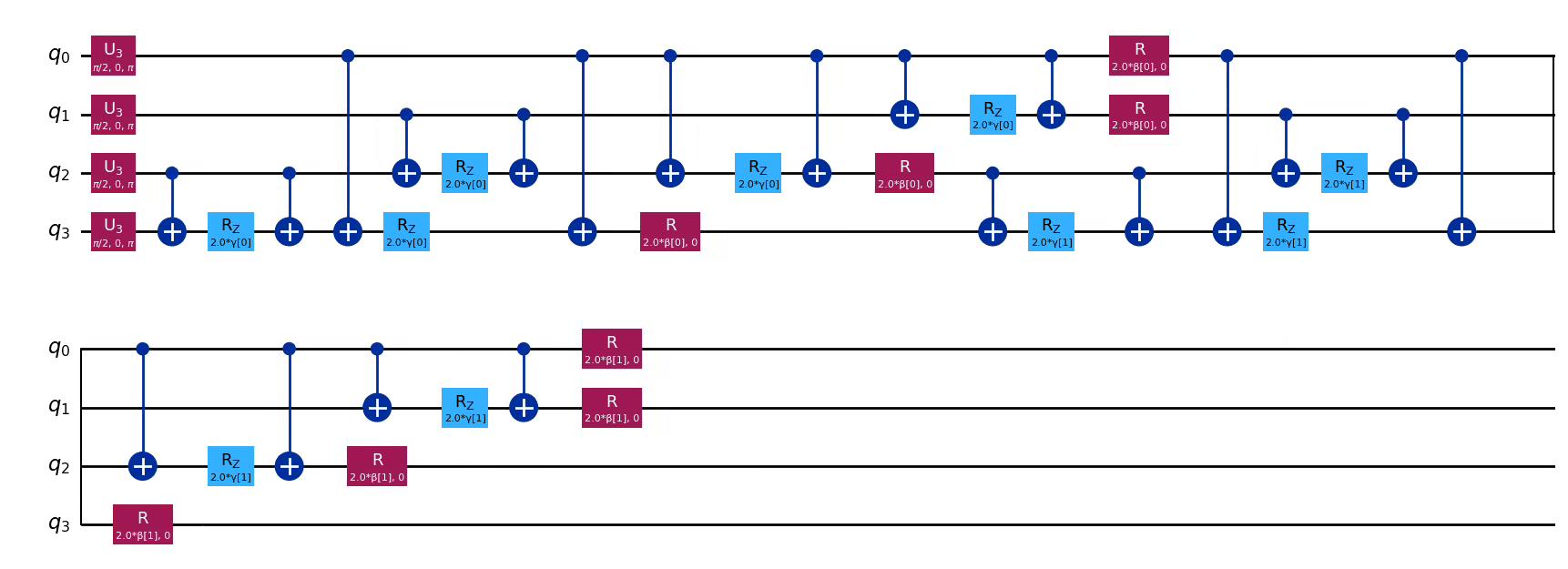

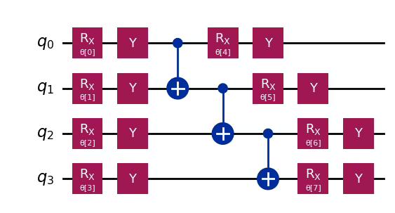

Efficient SU2
efficient_su2 is a hardware-efficient circuit that consists of layers of single-qubit operations spanning SU(2) and CX entanglements. This is a heuristic pattern that can be used to prepare trial wave functions for variational quantum algorithms or as a classification circuit for machine learning.
from qiskit.circuit.library import efficient_su2
ansatz = efficient_su2(4, su2_gates=["rx", "y"], entanglement="linear", reps=1)
Output:

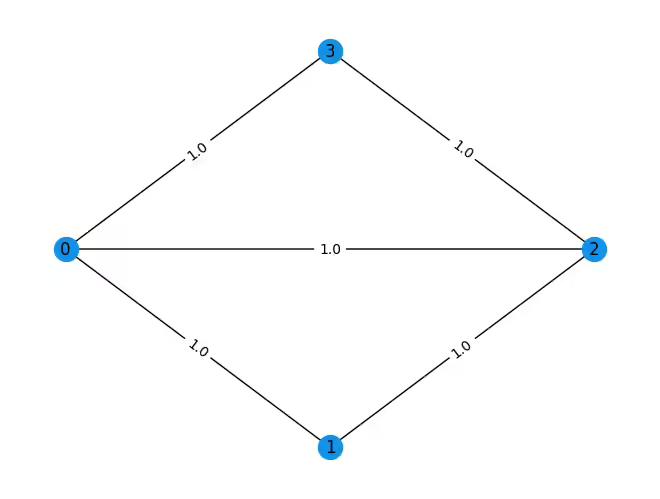

In a max-cut problem, we want to partition nodes of a graph in a way that maximizes the number of edges between nodes in differing groups. The desired max-cut partition for the graph below is clear: the 0th-node on the left should be separated from the rest of the nodes on the right by a cut.
import rustworkx as rx
from rustworkx.visualization import mpl_draw
n = 4
G = rx.PyGraph()
G.add_nodes_from(range(n))
# The edge syntax is (start, end, weight)
edges = [(0, 1, 1.0), (0, 2, 1.0), (0, 3, 1.0), (1, 2, 1.0), (2, 3, 1.0)]
G.add_edges_from(edges)
mpl_draw(
    G, pos=rx.shell_layout(G), with_labels=True, edge_labels=str, node_color="#1192E8"
Output:

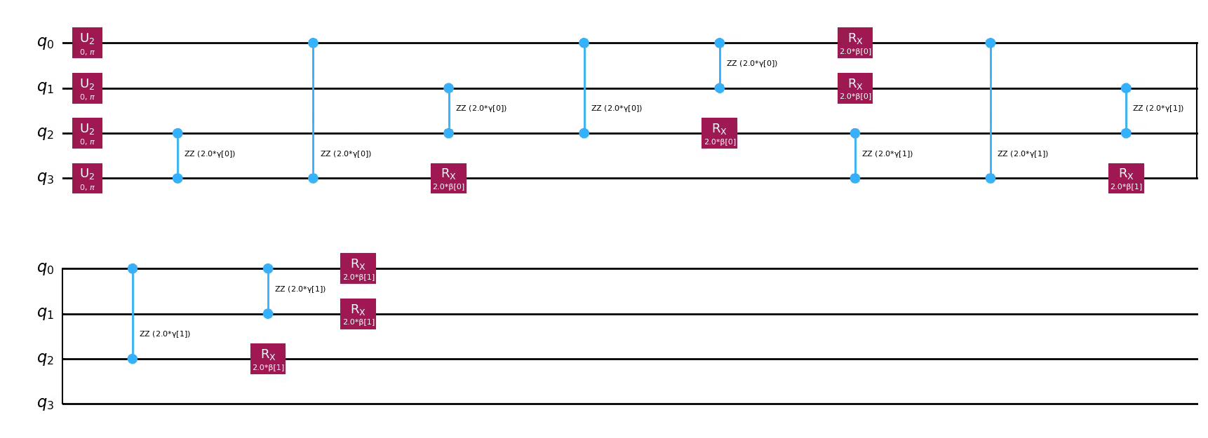

To utilize QAOA algorithm for a max-cut problem, we require a Pauli Hamiltonian that encodes the cost in a manner such that the minimum expectation value of the operator corresponds to the maximum number of edges between the nodes in two different groups.
For this simple example, the operator is a linear combination of terms with Z operators on nodes connected by an edge (recall that the 0th qubit is farthest right): ZZII+IZZI+ZIIZ+IZIZ+IIZZZZII + IZZI + ZIIZ + IZIZ + IIZZ. Once the operator is constructed, the ansatz for the QAOA algorithm can easily be built by using the QAOAAnsatz circuit from the Qiskit circuit library.
# Pre-defined ansatz circuit, operator class and visualization tools
from qiskit.circuit.library import QAOAAnsatz
from qiskit.quantum_info import SparsePauliOp
# Problem to Hamiltonian operator
hamiltonian = SparsePauliOp.from_list(
    [("ZZII", 1), ("IZZI", 1), ("ZIIZ", 1), ("IZIZ", 1), ("IIZZ", 1)]
# QAOA ansatz circuit
ansatz = QAOAAnsatz(hamiltonian, reps=2)
# Draw
ansatz.decompose(reps=3).draw("mpl")
Output:
The previous image illustrates the ansatz in basic gates for clarity. However, it can be expressed in multiple levels of decomposition by changing the reps argument or by drawing the circuit without the decompose method. For example, the following representation directly shows the QAOA structure with the default reps value, which is reps=1.
ansatz.decompose(reps=2).draw("mpl")
Output:

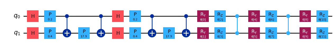

In machine learning, a common application is the classification of data into two or more categories. This involves encoding a datapoint into a feature map that maps classical feature vectors into the quantum Hilbert space. Constructing quantum feature maps based on parameterized quantum circuits that are hard to simulate classically is an important step towards obtaining a potential advantage over classical machine learning approaches and is an active area of current research.
The zz_feature_map can be used to create a parameterized circuit. We can pass in our data points to the feature map (xx) and a separate variational form to pass in weights as parameters (θ\theta).
from qiskit.circuit.library import zz_feature_map, TwoLocal
data = [0.1, 0.2]
zz_feature_map_reference = zz_feature_map(feature_dimension=2, reps=2)
zz_feature_map_reference = zz_feature_map_reference.assign_parameters(data)
variation_form = TwoLocal(2, ["ry", "rz"], "cz", reps=2)
vqc_ansatz = zz_feature_map_reference.compose(variation_form)
vqc_ansatz.decompose().draw("mpl")
Output:
