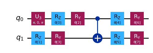

We'll first set up our problem before exploring each optimizer class. We will start with a circuit containing eight variational parameters:
from qiskit.quantum_info import SparsePauliOp
from qiskit.circuit.library import TwoLocal
import numpy as np
theta_list = (2 * np.pi * np.random.rand(1, 8)).tolist()
observable = SparsePauliOp.from_list([("XX", 1), ("YY", -3)])
reference_circuit = QuantumCircuit(2)
reference_circuit.x(0)
variational_form = TwoLocal(
    2,
    rotation_blocks=["rz", "ry"],
    entanglement_blocks="cx",
    entanglement="linear",
    reps=1,
ansatz = reference_circuit.compose(variational_form)
ansatz.decompose().draw("mpl")
Output:
Output of the previous code cell
