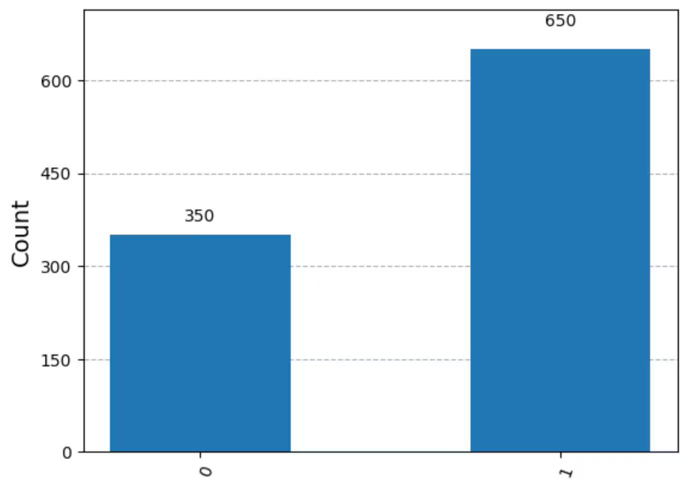

Step 4: Post-processing and analysis
Let's plot the results and interpret them.
# This required 5 s to run on a Heron r2 processor on 10-28-24
from qiskit.visualization import plot_histogram
plot_histogram(counts)
Output:
Output of the previous code cell
Check your understanding
Which of the states above indicate successful teleportation, and how can you tell?
  • The states 000,|000\rangle, 001,|001\rangle, 010,|010\rangle, 011|011\rangle are all consistent with successful teleportation. This is because we added a gate to undo the initial preparation of the secret state. If the secret state was successfully teleported to Bob's qubit, that additional gate should return Bob's qubit to the 0|0\rangle state. So any state above with Bob's qubit (qubit 0, also measured to the 0th component of the classical register, and hence the highest/right-most) in the 0|0\rangle state indicates success.
This plot is showing all measurement outcomes for the three qubits, over 5,000 trials or "shots". We pointed out earlier that Alice would measure all possible states for qubits A and Q with equal likelihood. We assigned qubits 0-2 in the circuit to Q, A, and B, in that order. In little-endian notation, Bob's qubit is the left-most/lowest. So the four bars on the left correspond to Bob's qubit being 0|0\rangle, and the other two qubits being in all possible combinations with roughly equal probability. Note that almost all (usually ~95%) of measurements yield Bob's qubit in the 0|0\rangle state, meaning our setup was successful! There are a handful of shots (~5%) that yielded Bob's qubit in the 1|1\rangle state. That should not logically be possible. However, all modern quantum computers suffer from noise and errors to a much greater extent than classical computers. And quantum error correction is still an emerging field.
