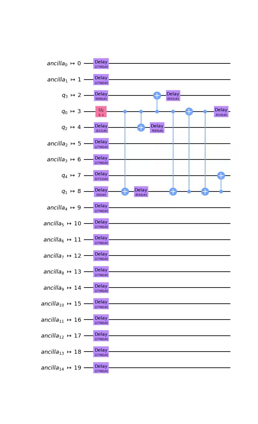

  6. scheduling - This stage is for any hardware-aware scheduling passes. See Scheduling Stage for more details.
When using transpile(), the implementation of each stage can be modified with the *_method arguments (e.g. layout_method). These can be set to one of the built-in methods and can also refer to available external plugins. See qiskit.transpiler.preset_passmanagers.plugin for details on this plugin interface.

If you’d like to work directly with a preset pass manager you can use the generate_preset_pass_manager() function to easily generate one. For example:
from qiskit.transpiler.preset_passmanagers import generate_preset_pass_manager
from qiskit.providers.fake_provider import FakeLagosV2
backend = FakeLagosV2()
pass_manager = generate_preset_pass_manager(3, backend)
which will generate a StagedPassManager object for optimization level 3 targeting the FakeLagosV2 backend (equivalent to what is used internally by transpile() with backend=FakeLagosV2() and optimization_level=3). You can use this just like you would any other PassManager. However, because it is a StagedPassManager it also makes it easy to compose and/or replace stages of the pipeline. For example, if you wanted to run a custom scheduling stage using dynamical decoupling (via the PadDynamicalDecoupling pass) and also add initial logical optimization prior to routing, you would do something like (building off the previous example):

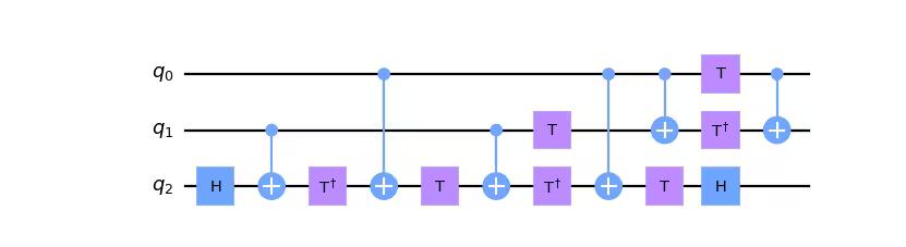

import numpy as np
from qiskit.circuit.library import HGate, PhaseGate, RXGate, TdgGate, TGate, XGate
from qiskit.transpiler import PassManager
from qiskit.transpiler.passes import (
    ALAPScheduleAnalysis,
    CXCancellation,
    InverseCancellation,
    PadDynamicalDecoupling,
dd_sequence = [XGate(), XGate()]
scheduling_pm = PassManager(
        ALAPScheduleAnalysis(target=backend.target),
        PadDynamicalDecoupling(target=backend.target, dd_sequence=dd_sequence),
inverse_gate_list = [
    HGate(),
    (RXGate(np.pi / 4), RXGate(-np.pi / 4)),
    (PhaseGate(np.pi / 4), PhaseGate(-np.pi / 4)),
    (TGate(), TdgGate()),
logical_opt = PassManager(
        CXCancellation(),
        InverseCancellation(inverse_gate_list),
# Add pre-layout stage to run extra logical optimization
pass_manager.pre_layout = logical_opt
# Set scheduling stage to custom pass manager
pass_manager.scheduling = scheduling_pm
Now, when the staged pass manager is run via the run() method, the logical_opt pass manager will be called before the layout stage, and the scheduling_pm pass manager will be used for the scheduling stage instead of the default.

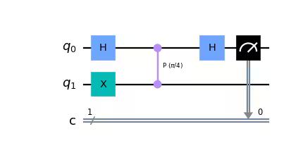

qc = QuantumCircuit(2, 1)
qc.h(0)
qc.x(1)
qc.cp(np.pi/4, 0, 1)
qc.h(0)
qc.measure([0], [0])
qc.draw(output='mpl')
../_images/transpiler-4.png
We have HH, XX, and controlled-PP gates, none of which are in our device’s basis gate set, and thus must be translated. This translation is taken care of for us in the qiskit.execute() function. However, we can transpile the circuit to show what it will look like in the native gate set of the target IBM Quantum device (the FakeVigoV2 backend is a fake backend that models the historical IBM Vigo 5 qubit device for test purposes):

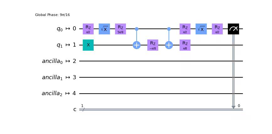

qc_basis = transpile(qc, backend)
qc_basis.draw(output='mpl')
../_images/transpiler-5.png
A few things to highlight. First, the circuit has gotten longer with respect to the original. This can be verified by checking the depth of both circuits:
print('Original depth:', qc.depth(), 'Decomposed Depth:', qc_basis.depth())
Original depth: 4 Decomposed Depth: 10
Second, although we had a single controlled gate, the fact that it was not in the basis set means that, when expanded, it requires more than a single CXGate to implement. All said, unrolling to the basis set of gates leads to an increase in the depth of a quantum circuit and the number of gates.

  2. A Toffoli, or controlled-controlled-not gate (ccx), is a three-qubit gate. Given that our basis gate set includes only single- and two-qubit gates, it is obvious that this gate must be decomposed. This decomposition is quite costly:
    ccx_circ = QuantumCircuit(3)
    ccx_circ.ccx(0, 1, 2)
    ccx_circ.decompose().draw(output='mpl')
    ../_images/transpiler-6.png
    For every Toffoli gate in a quantum circuit, the hardware may execute up to six CNOT gates, and a handful of single-qubit gates. From this example, it should be clear that any algorithm that makes use of multiple Toffoli gates will end up as a circuit with large depth and will therefore be appreciably affected by noise and gate errors.

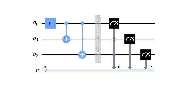

Let’s see what layouts are automatically picked at various optimization levels. The circuits returned by qiskit.compiler.transpile() are annotated with this initial layout information, and we can view this layout selection graphically using qiskit.visualization.plot_circuit_layout():
from qiskit import QuantumCircuit, transpile
from qiskit.visualization import plot_circuit_layout
from qiskit.providers.fake_provider import FakeVigo
backend = FakeVigo()
ghz = QuantumCircuit(3, 3)
ghz.h(0)
ghz.cx(0,range(1,3))
ghz.barrier()
ghz.measure(range(3), range(3))
ghz.draw(output='mpl')
../_images/transpiler-7.png

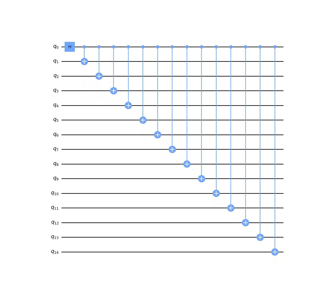

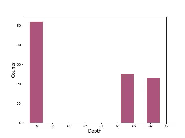

In order to highlight this, we run a GHZ circuit 100 times, using a “bad” (disconnected) initial_layout:
../_images/transpiler-11.png
from qiskit.providers.fake_provider import FakeAuckland
backend = FakeAuckland()
ghz = QuantumCircuit(15)
ghz.h(0)
ghz.cx(0, range(1, 15))
depths = []
for _ in range(100):
    depths.append(
        transpile(
            ghz,
            backend,
            layout_method='trivial'  # Fixed layout mapped in circuit order
        ).depth()
plt.figure(figsize=(8, 6))
plt.hist(depths, align='left', color='#AC557C')
plt.xlabel('Depth', fontsize=14)
plt.ylabel('Counts', fontsize=14);
../_images/transpiler-12.png
This distribution is quite wide, signaling the difficulty the swap mapper is having in computing the best mapping. Most circuits will have a distribution of depths, perhaps not as wide as this one, due to the stochastic nature of the default swap mapper. Of course, we want the best circuit we can get, especially in cases where the depth is critical to success or failure. The SabreSwap pass will by default by run its algorithm in parallel with multiple seed values and select the output which uses the fewest swaps. If you would like to increase the number of trials SabreSwap runs you can refer to Working with Preset Pass Managers and modify the routing stage with a custom instance of SabreSwap with a larger value for the trials argument.

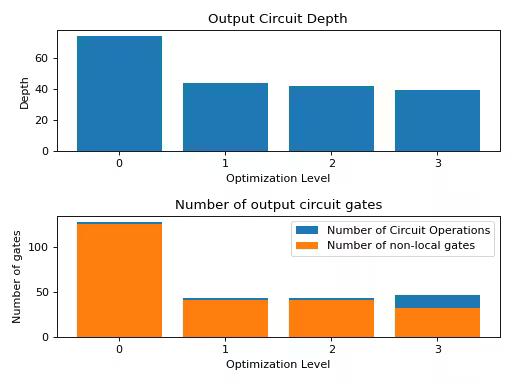

Decomposing quantum circuits into the basis gate set of the target device, and the addition of swap gates needed to match hardware topology, conspire to increase the depth and gate count of quantum circuits. Fortunately many routines for optimizing circuits by combining or eliminating gates exist. In some cases these methods are so effective the output circuits have lower depth than the inputs. In other cases, not much can be done, and the computation may be difficult to perform on noisy devices. Different gate optimizations are turned on with different optimization_level values. Below we show the benefits gained from setting the optimization level higher:
Important
The output from transpile() varies due to the stochastic swap mapper. So the numbers below will likely change each time you run the code.
../_images/transpiler-13.png
ghz.h(0)
depths = []
gate_counts = []
non_local_gate_counts = []
levels = [str(x) for x in range(4)]
for level in range(4):
     circ = transpile(ghz, backend, optimization_level=level)
     depths.append(circ.depth())
     gate_counts.append(sum(circ.count_ops().values()))
     non_local_gate_counts.append(circ.num_nonlocal_gates())
fig, (ax1, ax2) = plt.subplots(2, 1)
ax1.bar(levels, depths, label='Depth')
ax1.set_xlabel("Optimization Level")
ax1.set_ylabel("Depth")
ax1.set_title("Output Circuit Depth")
ax2.bar(levels, gate_counts, label='Number of Circuit Operations')
ax2.bar(levels, non_local_gate_counts, label='Number of non-local gates')
ax2.set_xlabel("Optimization Level")
ax2.set_ylabel("Number of gates")
ax2.legend()
ax2.set_title("Number of output circuit gates")
fig.tight_layout()
plt.show()
../_images/transpiler-14.png

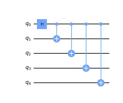

Scheduling Stage
After the circuit has been translated to the target basis, mapped to the device, and optimized, a scheduling phase can be applied to optionally account for all the idle time in the circuit. At a high level, the scheduling can be thought of as inserting delays into the circuit to account for idle time on the qubits between the execution of instructions. For example, if we start with a circuit such as:
../_images/transpiler-15.png
we can then call transpile() on it with scheduling_method set:
from qiskit.providers.fake_provider import FakeBoeblingen
backend = FakeBoeblingen()
ghz = QuantumCircuit(5)
ghz.h(0)
ghz.cx(0,range(1,5))
circ = transpile(ghz, backend, scheduling_method="asap")
circ.draw(output='mpl')
../_images/transpiler-16.png
You can see here that the transpiler inserted Delay instructions to account for idle time on each qubit. To get a better idea of the timing of the circuit we can also look at it with the timeline.draw() function:
