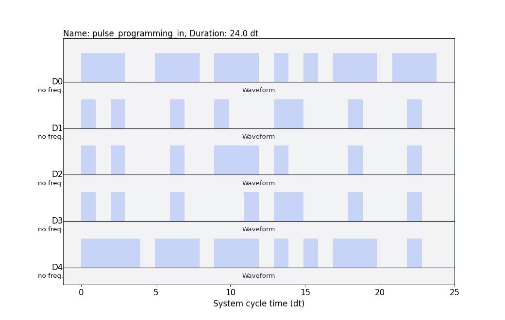

Pulse Builder
Use the pulse builder DSL to write pulse programs with an imperative syntax.
The pulse builder interface is still in active development. It may have breaking API changes without deprecation warnings in future releases until otherwise indicated.
The pulse builder provides an imperative API for writing pulse programs with less difficulty than the Schedule API. It contextually constructs a pulse schedule and then emits the schedule for execution. For example, to play a series of pulses on channels is as simple as:

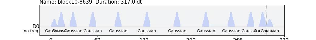

from qiskit import pulse
dc = pulse.DriveChannel
d0, d1, d2, d3, d4 = dc(0), dc(1), dc(2), dc(3), dc(4)
with pulse.build(name='pulse_programming_in') as pulse_prog:
pulse.play([1, 1, 1, 0, 0, 1, 1, 1, 0, 1, 1, 1, 0, 1, 0, 1, 0, 1, 1, 1, 0, 1, 1, 1], d0)
pulse.play([1, 0, 1, 0, 0, 0, 1, 0, 0, 1, 0, 0, 0, 1, 1, 0, 0, 0, 1, 0, 0, 0, 1, 0], d1)
pulse.play([1, 0, 1, 0, 0, 0, 1, 0, 0, 1, 1, 1, 0, 1, 0, 0, 0, 0, 1, 0, 0, 0, 1, 0], d2)
pulse.play([1, 0, 1, 0, 0, 0, 1, 0, 0, 0, 0, 1, 0, 1, 1, 0, 0, 0, 1, 0, 0, 0, 1, 0], d3)
pulse.play([1, 1, 1, 1, 0, 1, 1, 1, 0, 1, 1, 1, 0, 1, 0, 1, 0, 1, 1, 1, 0, 0, 1, 0], d4)
pulse_prog.draw()
To begin pulse programming we must first initialize our program builder context with build(), after which we can begin adding program statements. For example, below we write a simple program that play()s a pulse:

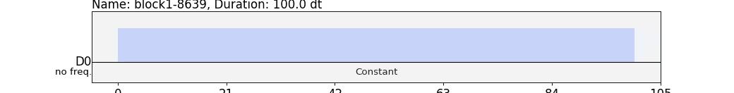

d0 = pulse.DriveChannel(0)
with pulse.build() as pulse_prog:
pulse.play(pulse.Constant(100, 1.0), d0)
pulse_prog.draw()

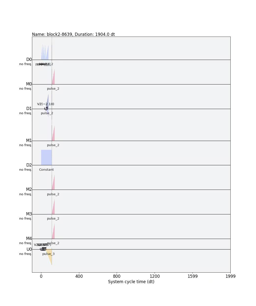

from math import pi
from qiskit.compiler import schedule
from qiskit.providers.fake_provider import GenericBackendV2
backend = GenericBackendV2(num_qubits=5, calibrate_instructions=True)
d2 = pulse.DriveChannel(2)
qc = QuantumCircuit(2)
# Hadamard
qc.rz(pi/2, 0)
qc.sx(0)
qc.rz(pi/2, 0)
qc.cx(0, 1)
bell_sched = schedule(qc, backend)
with pulse.build(backend) as decoupled_bell_prep_and_measure:
# We call our bell state preparation schedule constructed above.
with pulse.align_right():
pulse.call(bell_sched)
pulse.play(pulse.Constant(bell_sched.duration, 0.02), d2)
pulse.barrier(0, 1, 2)
registers = pulse.measure_all()
decoupled_bell_prep_and_measure.draw()

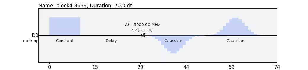

with pulse.build(backend) as pulse_prog:
# Create a pulse.
gaussian_pulse = pulse.Gaussian(10, 1.0, 2)
# Get the qubit's corresponding drive channel from the backend.
d0 = pulse.drive_channel(0)
d1 = pulse.drive_channel(1)
# Play a pulse at t=0.
pulse.play(gaussian_pulse, d0)
# Play another pulse directly after the previous pulse at t=10.
# The default scheduling behavior is to schedule pulses in parallel
# across channels. For example, the statement below
# plays the same pulse on a different channel at t=0.
pulse.play(gaussian_pulse, d1)
# We also provide pulse scheduling alignment contexts.
# The default alignment context is align_left.
# The sequential context schedules pulse instructions sequentially in time.
# This context starts at t=10 due to earlier pulses above.
with pulse.align_sequential():
# Play another pulse after at t=20.
# We can also nest contexts as each instruction is
# contained in its local scheduling context.
# The output of a child context is a context-schedule
# with the internal instructions timing fixed relative to
# one another. This is schedule is then called in the parent context.
# Context starts at t=30.
with pulse.align_left():
# Start at t=30.
# Start at t=30.
# Context ends at t=40.
# Alignment context where all pulse instructions are
# aligned to the right, ie., as late as possible.
# Shift the phase of a pulse channel.
pulse.shift_phase(math.pi, d1)
# Starts at t=40.
pulse.delay(100, d0)
# Ends at t=140.
# Starts at t=130.
# Ends at t=140.
# Acquire data for a qubit and store in a memory slot.
pulse.acquire(100, 0, pulse.MemorySlot(0))
# We also support a variety of macros for common operations.
# Measure all qubits.
pulse.measure_all()
# Delay on some qubits.
# This requires knowledge of which channels belong to which qubits.
# delay for 100 cycles on qubits 0 and 1.
pulse.delay_qubits(100, 0, 1)
# Call a schedule for a quantum circuit thereby inserting into
# the pulse schedule.
qc = QuantumCircuit(2, 2)
qc.cx(0, 1)
qc_sched = schedule(qc, backend)
pulse.call(qc_sched)
# It is also be possible to call a preexisting schedule
tmp_sched = pulse.Schedule()
tmp_sched += pulse.Play(gaussian_pulse, d0)
pulse.call(tmp_sched)
# We also support:
# frequency instructions
pulse.set_frequency(5.0e9, d0)
# phase instructions
pulse.shift_phase(0.1, d0)
# offset contexts
with pulse.phase_offset(math.pi, d0):
pulse.play(gaussian_pulse, d0)The above is just a small taste of what is possible with the builder. See the rest of the module documentation for more information on its capabilities.

pulse.shift_frequency(1e7, d0)
pulse.set_frequency(5e9, d0)
with pulse.build() as temp_sched:
pulse.play(pulse.Gaussian(20, 1.0, 3.0), d0)
pulse.play(pulse.Gaussian(20, -1.0, 3.0), d0)
pulse.call(temp_sched)
pulse.acquire(30, a0, pulse.MemorySlot(0))
drive_sched.draw()

This directive prevents the compiler from moving instructions across the barrier. Consider the case where we want to enforce that one pulse happens after another on separate channels, this can be done with:
from qiskit.providers.fake_provider import FakeOpenPulse2Q
backend = FakeOpenPulse2Q()
d1 = pulse.DriveChannel(1)
with pulse.build(backend) as barrier_pulse_prog:
pulse.play(pulse.Constant(10, 1.0), d0)
pulse.barrier(d0, d1)
pulse.play(pulse.Constant(10, 1.0), d1)Of course this could have been accomplished with:
from qiskit.pulse import transforms
with pulse.build(backend) as aligned_pulse_prog:
barrier_pulse_prog = transforms.target_qobj_transform(barrier_pulse_prog)
aligned_pulse_prog = transforms.target_qobj_transform(aligned_pulse_prog)
assert barrier_pulse_prog == aligned_pulse_progThe barrier allows the pulse compiler to take care of more advanced scheduling alignment operations across channels. For example in the case where we are calling an outside circuit or schedule and want to align a pulse at the end of one call:
pulse.play(pulse.Constant(10, 1.0), d0)Parameters

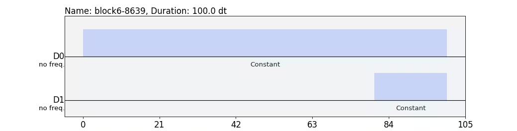

Builder aware contexts that modify the construction of a pulse program. For example an alignment context like align_right() may be used to align all pulses as late as possible in a pulse program.
# this pulse will start at t=0
# this pulse will start at t=80
pulse.play(pulse.Constant(20, 1.0), d1)
pulse_prog.draw()

The function qiskit.pulse.builder.align_equispaced() is deprecated as of Qiskit 1.3. It will be removed in Qiskit 2.0. The entire Qiskit Pulse package is being deprecated and will be moved to the Qiskit Dynamics repository: https://github.com/qiskit-community/qiskit-dynamics
Examples:
x90 = pulse.Gaussian(10, 0.1, 3)
x180 = pulse.Gaussian(10, 0.2, 3)
with pulse.build() as hahn_echo:
with pulse.align_equispaced(duration=100):
pulse.play(x90, d0)
pulse.play(x180, d0)
pulse.play(x90, d0)
hahn_echo.draw()

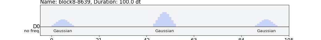

align_func
qiskit.pulse.builder.align_func(duration, func)
Callback defined alignment pulse scheduling context.
Pulse instructions within this context are scheduled at the location specified by arbitrary callback function position that takes integer index and returns the associated fractional location within [0, 1]. Delay instruction is automatically inserted in between pulses.
This context may be convenient to write a schedule of arbitrary dynamical decoupling sequences such as Uhrig dynamical decoupling.
The function qiskit.pulse.builder.align_func() is deprecated as of Qiskit 1.3. It will be removed in Qiskit 2.0. The entire Qiskit Pulse package is being deprecated and will be moved to the Qiskit Dynamics repository: https://github.com/qiskit-community/qiskit-dynamics
Examples:
import numpy as np
def udd10_pos(j):
return np.sin(np.pi*j/(2*10 + 2))**2
with pulse.build() as udd_sched:
pulse.play(x90, d0)
with pulse.align_func(duration=300, func=udd10_pos):
for _ in range(10):
pulse.play(x90, d0)
udd_sched.draw()
pulse_prog = pulse.transforms.block_to_schedule(pulse_prog)
assert pulse_prog.ch_stop_time(d0) == pulse_prog.ch_stop_time(d1)Yields
