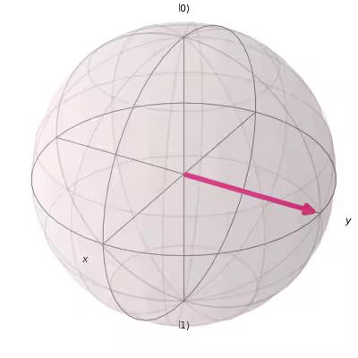

from qiskit.visualization import plot_bloch_vector
plot_bloch_vector([0,1,0], title="New Bloch Sphere")
Output from the previous code.

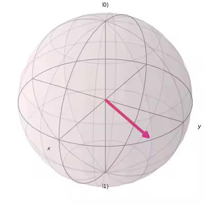

import numpy as np
# You can use spherical coordinates instead of cartesian.
plot_bloch_vector([1, np.pi/2, np.pi/3], coord_type='spherical')
