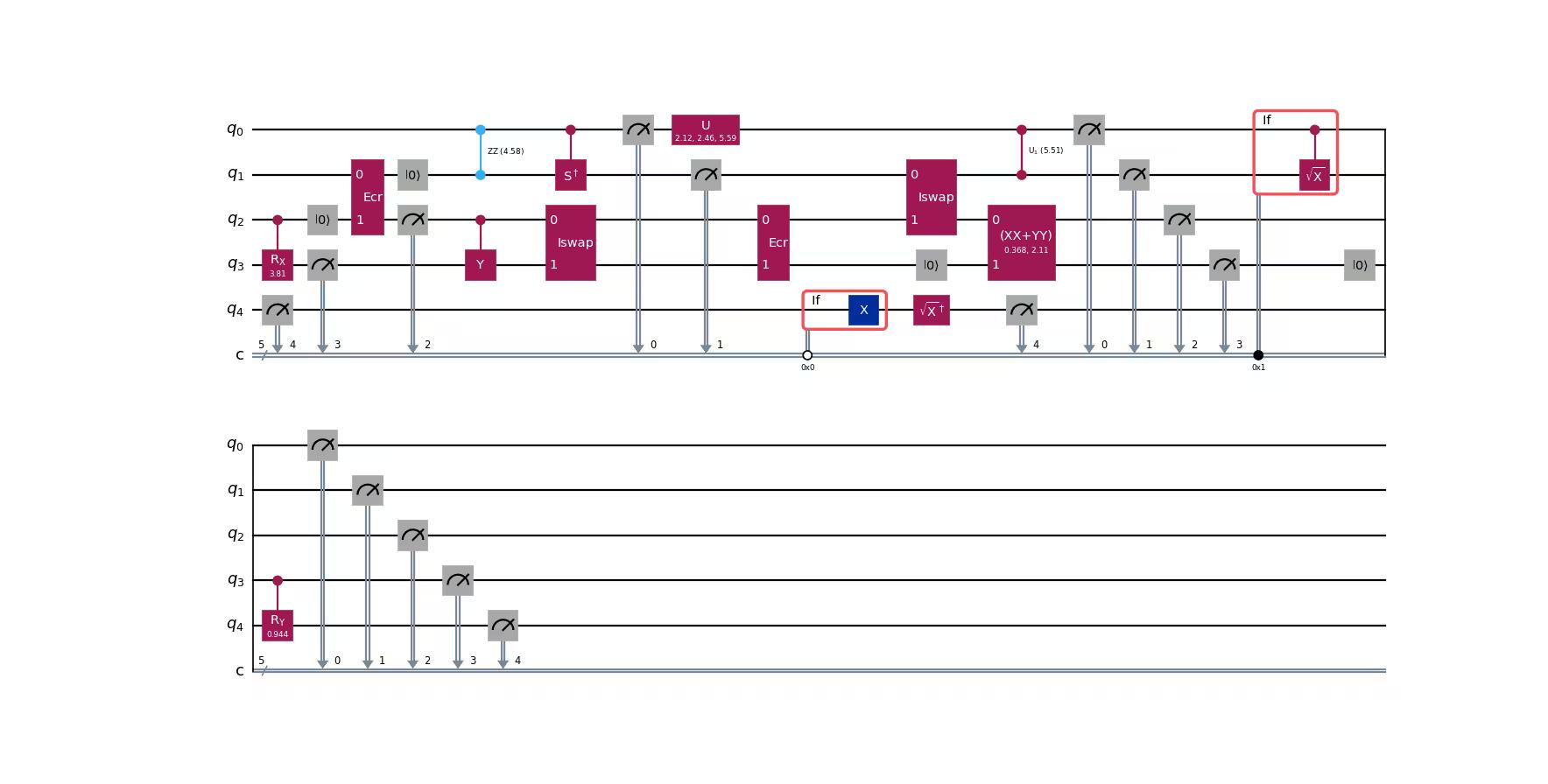

  • Added a function random_circuit_from_graph() that generates a random circuit that induces the same interaction graph as the one specified by interaction_graph.
    The probability of randomly drawing an edge from the interaction graph as a two-qubit gate can be set by the user in an edge’s weight attribute in the input interaction graph. If the user does not set the probability, each edge is drawn uniformly. That is, each two-qubit gate represented by an edge in the interaction graph has the same probability of getting added to the random circuit. If only a subset of edge probabilities are set, ValueError will be raised.
    In this example, cp_map is a list of edges with arbitrary weights.
    from qiskit.circuit.random.utils import random_circuit_from_graph
    import rustworkx as rx
    pydi_graph = rx.PyDiGraph()
    n_q = 5
    cp_map = [(0, 1, 0.18), (1, 2, 0.15), (2, 3, 0.15), (3, 4, 0.22)]
    pydi_graph.extend_from_weighted_edge_list(cp_map)
    # cp_map can be passed in directly as interaction_graph
    qc = random_circuit_from_graph(interaction_graph = pydi_graph,
      min_2q_gate_per_edge = 1,
      max_operands = 2,
      measure = True,
      conditional = True,
      reset = True,
      seed = 0,
      insert_1q_oper = True,
      prob_conditional = 0.21,
      prob_reset = 0.1)
    qc.draw(output='mpl')
    _images/release_notes-1.png
