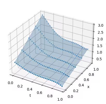

For Burgers' equation, when initial conditions are set to u(0,x)=xu(0,x) = x, the results are as follows:
# launch the simulation with initial conditions u(0,x) = a*x + b
job = quick.run(
    use_case="CFD_BURGER", physical_parameters={"a": 1.0, "b": 0.0}
Check your Qiskit Function workload's status or return results as follows:
# Print the ID so you can use it later, if necessary
print(job.job_id)
print(job.status())
solution = job.result()

# Call
plot_result_3d(solution)

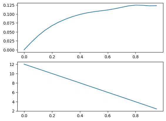

# Plot the result
_ = plt.figure()
stress_plot = plt.subplot(211)
plt.plot(solution["samples"]["x"], solution["functions"]["u"])
strain_plot = plt.subplot(212)
plt.plot(solution["samples"]["x"], solution["functions"]["sigma"])
plt.show()
