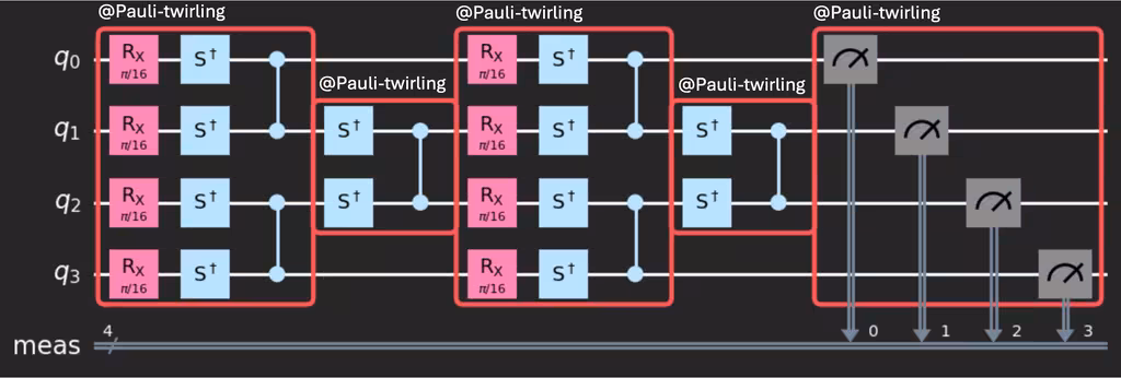

Samplomatic is a new open-source library that supports customized sampling randomizations. It uses the box construct to reason about collections of circuit operations that should be treated as having a stable noise context, and uses annotations on boxes to allow you to declare and configure intents. For example, you can stratify your circuit into boxes, add a twirling annotation to each box, and specify which twirling group to use, as shown in the following figure:
Example of using boxes and twirling annotations
A circuit with annotated boxes can then be used to generate a template circuit and a samplex. The output template circuit is a parameterized circuit that will be executed without further alteration (other than having different parameter values assigned to it). The samplex, which is the core type of the Samplomatic library, represents a parametric probability distribution over the parameters of the template circuit and other array-valued fields. These fields can be used to post-process data collected from executing the bound template circuit. In other words, the template circuit and samplex together tell the Executor primitive what parameters to generate and what bound circuits to run. Because these two constructs are created on the client side, you can do local inspection and sampling to verify the outputs prior to sending it for hardware execution.
