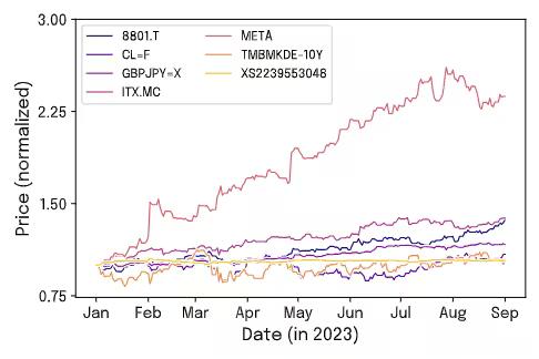

For this example, we have used the assets 8801.T, CLF, GBPJPY, ITX.MC, META, TMBMKDE-10Y, and XS2239553048. The following figure illustrates the data used in this example, showing the daily closing price evolution of the assets from 1 January to 1 September in 2023.
In this example, to ensure uniformity across dates, we have filled non-trading days with the closing price from the previous available date. We apply this step because the selected assets come from different markets with varying trading days, making it essential to standardize the dataset for consistency.
Visualization of the historical data of the assets

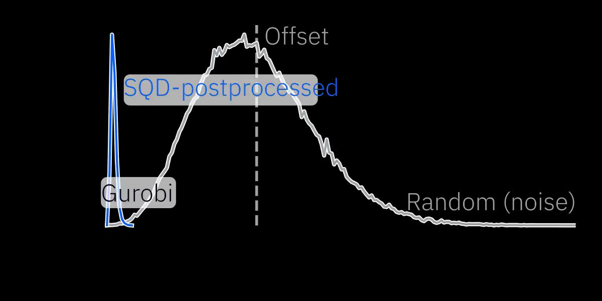

6. Performance analysis
Last, analyze the performance of your optimization application. Specifically, compare your results, obtained in the previous example, against a random baseline to assess the effectiveness of our approach. If the quantum algorithm demonstrably and consistently produces results with lower cost values, it indicates an effective optimization process.
The figure presents the probability distributions of the objective costs. To generate these distributions, take the list of objective costs from the function result and count the occurrences of each cost value (values rounded to the second decimal place). Then, update the count column accordingly by joining counts of identical rounded values. Note that, for better visual comparison, the occurrence counts have been normalized so that each distribution is displayed between 0 and 1.
Visualization of the solution of the optimization
As shown in the figure (blue solid line), the cost distribution for our Variational Quantum Eigensolver (post-processed with SQD) approach is sharply concentrated at lower objective cost values, indicating good optimization performance. In contrast, the noisy baseline exhibits a broader distribution, centered around higher cost values. The gray dashed vertical line represents the mean value of the random distribution, further highlighting the consistency of the function in returning optimized investment strategies. For an additional comparison, the black dashed line in the figure corresponds to the solution obtained with the Gurobi optimizer (free version). All these results are further explored in the benchmarks below for the "Mixed Assets" example evaluated with the "Tailored" ansatz.
