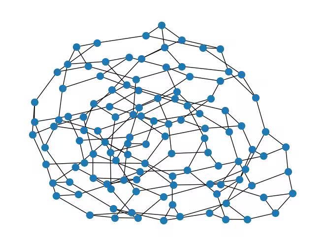

# %pip install networkx numpy1. Define the problem
You can run a max-cut problem by defining a graph problem and specifying problem_type='maxcut'.
import networkx as nx
import numpy as np
# Generate a random graph with 100 nodes
maxcut_graph = nx.random_regular_graph(d=3, n=100, seed=8)# Optionally, visualize the graph
nx.draw_networkx(
maxcut_graph, nx.kamada_kawai_layout(maxcut_graph), node_size=100
)Output:
The Solver accepts a string as the problem definition input.
# Convert graph to string
problem_as_str = nx.readwrite.json_graph.adjacency_data(maxcut_graph)2. Run the problem
When using the graph-based input method, specify the problem type. Calculate the function size from maxcut_graph, then pass the returned value to solver.run through function_size.
# Calculate the workload size
maxcut_size = calculate_function_size(
maxcut_graph.number_of_nodes(),
maxcut_graph.number_of_edges(),
print(f"Workload size: {maxcut_size}")Output:
Workload size: M

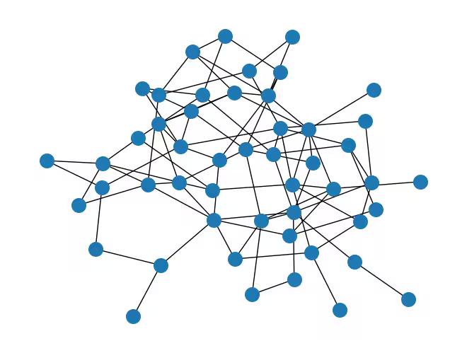

# %pip install numpy networkx sympy1. Define the problem
Define a random graph partitioning problem by generating a graph with randomly weighted nodes.
from sympy import Symbol, Poly, srepr
# To change the weights, change the seed to any integer.
rng_seed = 18
_rng = np.random.default_rng(rng_seed)
node_count = 50
edge_probability = 0.08
graph = nx.erdos_renyi_graph(
node_count, edge_probability, seed=rng_seed, directed=False
# add node weights
min_weight = -1.0
max_weight = 1.0
for i in graph.nodes:
weight = (max_weight - min_weight) * _rng.random() + min_weight
graph.add_node(i, weight=weight)
nx.draw_networkx(graph, nx.kamada_kawai_layout(graph), node_size=200)Output:
