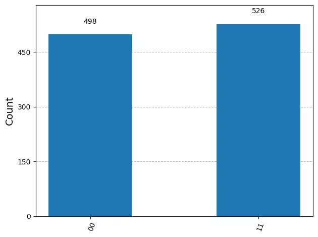

3. Visualize your results
To get a histogram of your results, add the following code to your program.
# Uncomment lines 2 and 8 if you are not using Python in a Jupyter notebook
# import matplotlib.pyplot as plt
from qiskit.visualization import plot_histogram
counts = result[0].data.meas.get_counts()
plot_histogram(counts)
# plt.show()Output:
This result is a signature of quantum entanglement.
