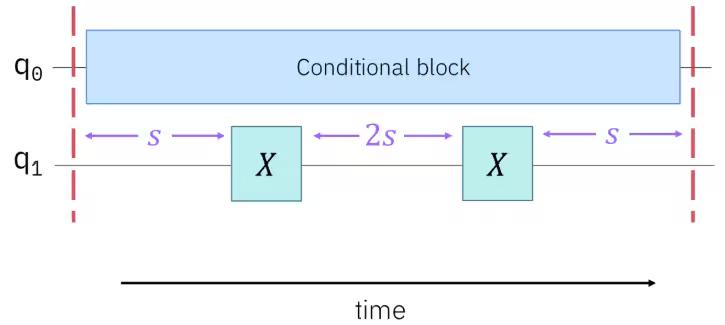

A common use case of stretch is to apply dynamical decoupling to an idling qubit while another qubit is undergoing conditional operations.
For example, we can use stretch to apply an XX dynamical decoupling sequence to qubit 1, for the duration of the conditional block applied to qubit 0, as illustrated by the following diagram:
Image illustrating the following circuit
The corresponding circuit would look like the following. Note that a pair of barriers is needed to define the boundaries of this relative timing.

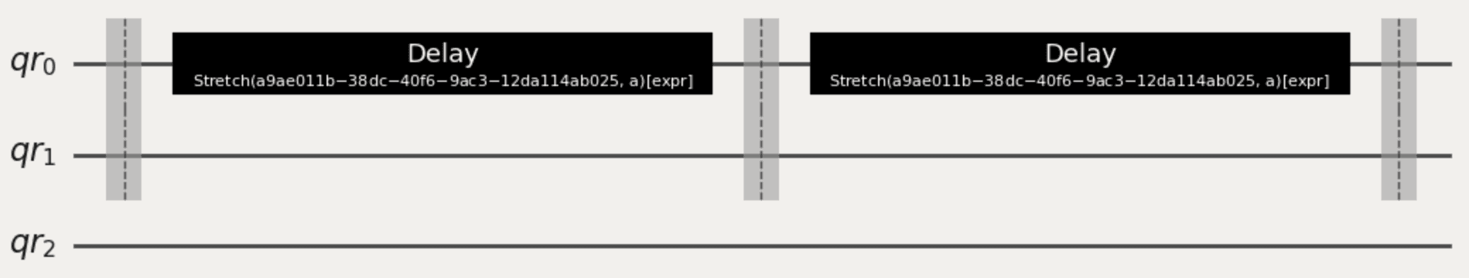

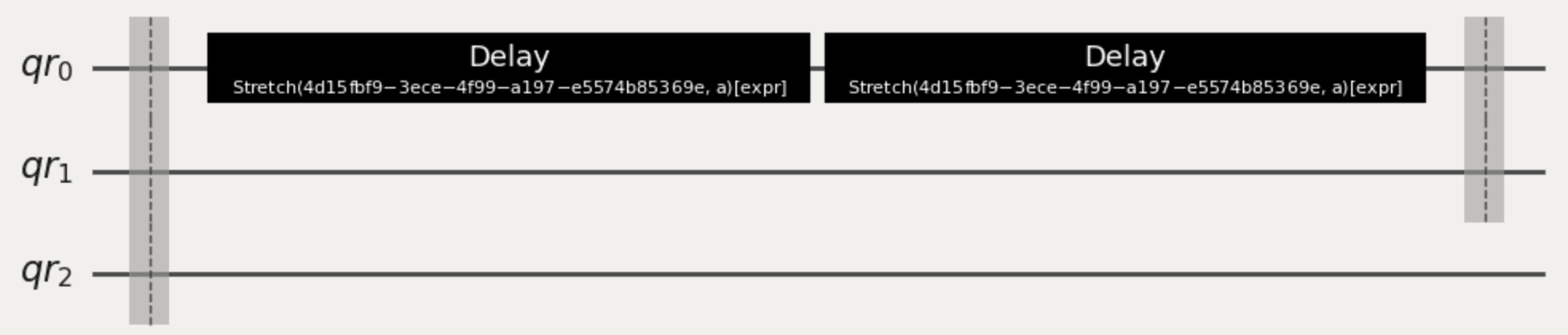

  • The area surrounded by a set of barriers is called a barrier region. A stretch variable cannot be used in multiple barrier regions.
    # Stretch a is used in two barrier regions
    a = circuit.add_stretch("a")
    circuit.barrier((q0, q1))
    circuit.delay(a, q0)
    Illustration of the previous code output
    Invalid use of stretch in barrier regions
