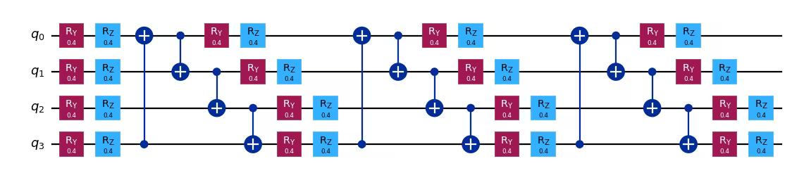

circuit = EfficientSU2(num_qubits=4, entanglement="circular").decompose()
circuit.assign_parameters([0.4] * len(circuit.parameters), inplace=True)
observables = PauliList(["ZZII", "IZZI", "IIZZ", "XIXI", "ZIZZ", "IXIX"])
circuit.draw("mpl", scale=0.8, style="iqp")
Output:
Output of the previous code cell

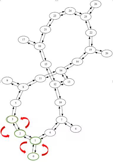

We choose an initial layout that requires two swaps to execute the gates between qubits 3 and 0 and another two swaps to return the qubits to their initial positions. We choose optimization_level=3, which is the highest level of optimization available with a preset pass manager.

Coupling map showing the qubits that will need to be swapped

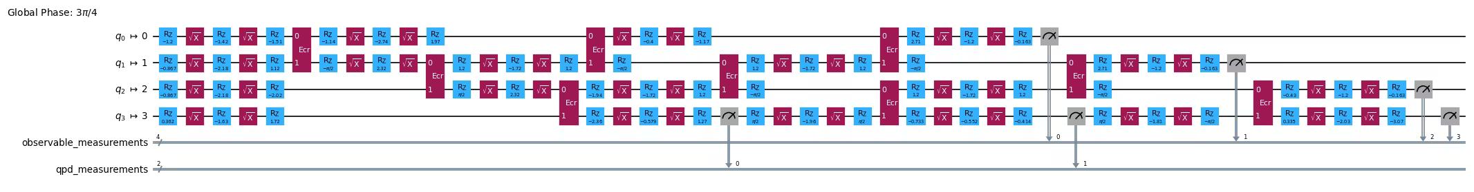

Transpiled circuit depth: 103

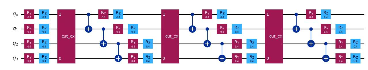

Find and cut the distant gates: We will replace the distant gates (gates connecting non-local qubits, 0 and 3) with TwoQubitQPDGate objects by specifying their indices. cut_gates will replace the gates in the specified indices with TwoQubitQPDGate objects and also return a list of QPDBasis instances -- one for each gate decomposition. The QPDBasis object contains information about how to decompose the cut gates into single-qubit operations.
# Find the indices of the distant gates
cut_indices = [
    i
    for i, instruction in enumerate(circuit.data)
    if {circuit.find_bit(q)[0] for q in instruction.qubits} == {0, 3}
# Decompose distant CNOTs into TwoQubitQPDGate instances
qpd_circuit, bases = cut_gates(circuit, cut_indices)
qpd_circuit.draw("mpl", scale=0.8)
Output:

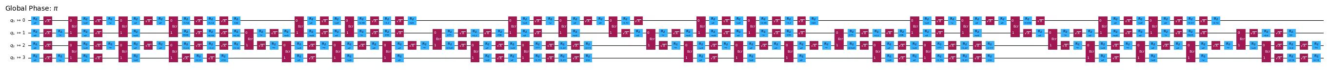

For comparison, we see that the QPD subexperiments will be shallower after cutting distant gates: Here is an example of an arbitrarily chosen subexperiment generated from the QPD circuit. Its depth has been reduced by more than half. Many of these probabilistic subexperiments must be generated and evaluated in order to reconstruct an expectation value of the deeper circuit.
# Transpile the decomposed circuit to the same layout
transpiled_qpd_circuit = pm.run(subexperiments[100])
print(f"Original circuit depth after transpile: {transpiled_qc.depth()}")
print(
    f"QPD subexperiment depth after transpile: {transpiled_qpd_circuit.depth()}"
transpiled_qpd_circuit.draw(
    "mpl", scale=0.6, style="iqp", idle_wires=False, fold=-1
Output:
Original circuit depth after transpile: 103
QPD subexperiment depth after transpile: 46
