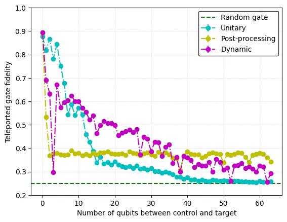

Plot the results
To appreciate the results visually, the cell below plots the estimated gate fidelities measured at varying distance between entangled qubits for each method.
fig, ax = plt.subplots()
# Unitary with error bars
ax.errorbar(
    distances,
    avg_fidelities_uni,
    yerr=std_fidelities_uni,
    fmt="o-.",
    color="c",
    ecolor="c",
    elinewidth=1,
    capsize=4,
    label="Unitary",
# Dynamic with error bars
ax.errorbar(
    distances,
    avg_fidelities_dyn,
    yerr=std_fidelities_dyn,
    fmt="o-.",
    color="m",
    ecolor="m",
    elinewidth=1,
    capsize=4,
    label="Dynamic",
# Random gate baseline
ax.axhline(y=1 / 4, linestyle="--", color="gray", label="Random gate")
legend = ax.legend(frameon=True)
for text in legend.get_texts():
    text.set_color("black")
legend.get_frame().set_facecolor("white")
legend.get_frame().set_edgecolor("black")
ax.set_title(
    "Bell State Fidelity vs Control–Target Separation", color="black"
ax.set_xlabel("Distance", color="black")
ax.set_ylabel("Bell state fidelity", color="black")
ax.grid(linestyle=":", linewidth=0.6, alpha=0.4, color="gray")
ax.set_ylim((0.2, 1))
ax.set_facecolor("white")
fig.patch.set_facecolor("white")
for spine in ax.spines.values():
    spine.set_visible(True)
    spine.set_color("black")
ax.tick_params(axis="x", colors="black")
ax.tick_params(axis="y", colors="black")
plt.show()
Output:
Output of the previous code cell
From the fidelity plot above, the LRCX did not consistently outperform the direct unitary implementation. In fact, for short control–target separations, the unitary circuit achieved higher fidelity. However, at larger separations, the dynamic circuit begins to achieve better fidelity than the unitary implementation. This behavior is not unexpected on current hardware: while dynamic circuits reduce circuit depth by avoiding long SWAP chains, they introduce additional circuit time from mid-circuit measurements, classical feedforward, and control-path delays. The added latency increases decoherence and readout errors, which can outweigh the depth savings at short distances.
Nevertheless, we observe a crossover point where the dynamic approach surpasses the unitary one. This is a direct result of the different scaling: the depth of the unitary circuit grows linearly with the distance between qubits, while the depth of the dynamic circuit remains constant.
Key points:
  • Immediate benefit of dynamic circuits: The main present-day motivation is reduced two-qubit depth, not necessarily improved fidelity.
  • Why fidelity can be worse today: Increased circuit time from measurement and classical operations often dominates, especially when the control–target separation is small.
  • Looking forward: As hardware improves, specifically faster readout, shorter classical control latency, and reduced mid-circuit overhead, we should expect these depth and duration reductions to translate into measurable fidelity gains.

axes[0].plot(
    distances, depths_2q_uni, "o-.", color="c", label="Unitary (2Q depth)"
axes[0].plot(
    distances, depths_2q_dyn, "o-.", color="m", label="Dynamic (2Q depth)"
axes[0].set_xlabel("Number of qubits between control and target")
axes[0].set_ylabel("Two-qubit depth")
axes[0].grid(True, linestyle=":", linewidth=0.6, alpha=0.4)
axes[0].legend()
axes[1].plot(
    distances, meas_uni, "o-.", color="c", label="Unitary (# measurements)"
axes[1].plot(
    distances, meas_dyn, "o-.", color="m", label="Dynamic (# measurements)"
axes[1].set_xlabel("Number of qubits between control and target")
axes[1].set_ylabel("Number of measurements")
axes[1].grid(True, linestyle=":", linewidth=0.6, alpha=0.4)
axes[1].legend()
fig.suptitle("Scaling of Unitary vs Dynamic LRCX with Distance", fontsize=12)
plt.tight_layout()
plt.show()
Output:
This two-qubit depth plot highlights the primary advantage of the LRCX implemented with dynamic circuits: performance remains essentially constant as the separation between control and target qubits increases. In contrast, the unitary implementation grows linearly with distance due to the required SWAP chains. Depth captures the logical scaling of two-qubit operations, while the measurement count reflects the additional overhead for dynamic circuits. These measurements are efficient, since they are performed in parallel, but they still introduce a fixed cost on today’s hardware.
Why fidelity can be worse today: Increased circuit time from measurement and classical operations often dominates, especially when the control-target separation is small. For example, the average readout length on a Heron r2 processor is 2,280 ns, whereas its 2Q gate length is only 68 ns.
As measurement and classical latencies improve, we expect the constant-depth and constant-measurement scaling of dynamic circuits to yield clear fidelity and runtime advantages on larger circuits.
