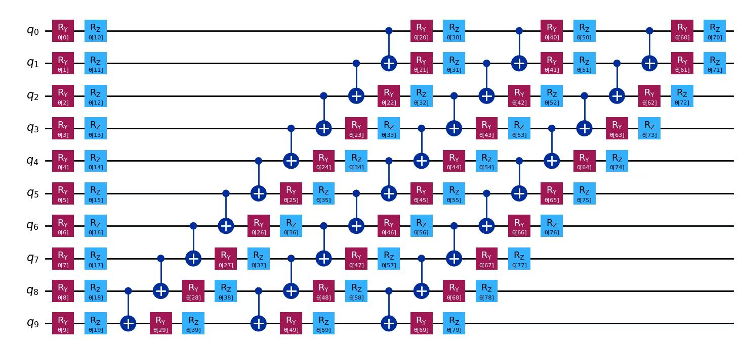

Construct an ansatz and Hamiltonian that model a 10-spin Heisenberg chain. In this step, we will build a 10-spin Heisenberg Hamiltonian over the least-busy backend's coupling map and prepare the efficient_su2 ansatz.
num_spins = 10
ansatz = efficient_su2(num_qubits=num_spins, reps=2)

ansatz.draw("mpl", style="iqp")

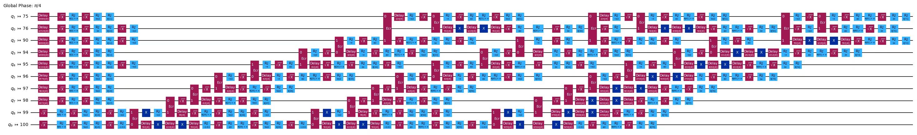

isa_ansatz = pm.run(ansatz)
isa_observable = hamiltonian.apply_layout(isa_ansatz.layout)
isa_ansatz.draw("mpl", scale=0.6, style="iqp", fold=-1, idle_wires=False)

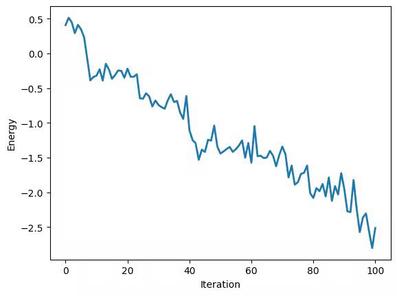

print(f"Estimated ground state energy: {spsa_min}")
Output:
Estimated ground state energy: [-3.03842968]
results = {
    "spsa": spsa_history,
visualize_results(spsa_history)
Output:
