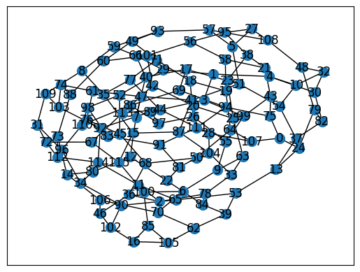

# Generate a random graph with 156 nodes
maxcut_graph = nx.random_regular_graph(d=3, n=116, seed=8)
# Optionally, visualize the graph
nx.draw(maxcut_graph, nx.kamada_kawai_layout(maxcut_graph), node_size=100)
Output:

The Solver accepts a string as the problem definition input.
# Convert graph to string
problem_as_str = nx.readwrite.json_graph.adjacency_data(maxcut_graph)
