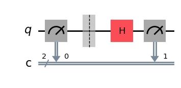

Step 1: Map classical inputs to a quantum problem
In this case, the mapping step is simply expressing the measurements and rotations described above in a quantum circuit:
# Step 1: Map
# Import some general packages
from qiskit import ClassicalRegister, QuantumCircuit, QuantumRegister
# Define registers
qr = QuantumRegister(1, "q")
cr = ClassicalRegister(2, "c")
qc = QuantumCircuit(qr, cr)
# Add a first measurement
qc.measure(qr, cr[0])
qc.barrier()
# Change basis so that measurements made on quantum computer which normally tell us about z, now tell us about x.
qc.h(qr)
# Add a second measurement
qc.measure(qr, cr[1])
qc.draw("mpl")

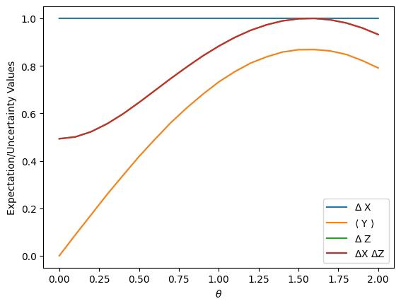

Now we see that the limit on the uncertainty (ΔXΔZ)(\Delta X \Delta Z) is being put to the test! The red curve comes much closer to the orange curve than before. In fact, in the absence of noise, the uncertainty relation would be exactly saturated ((ΔXΔZ)=Y(\Delta X \Delta Z) = \langle Y \rangle) one point. In the presence of noise and readout error, it should not be surprising if a run occasionally yields (ΔXΔZ)(\Delta X \Delta Z) very slightly larger than Y.\langle Y \rangle. This is not a true violation of uncertainty; it is just an artifact of non-zero error.
Check your understanding
Explain how you would push this to the absolute limit, making Y\langle Y \rangle as large as possible.
  • The code currently has lines that rotate the default initial state 0|0\rangle, down from the zz axis by some parametrized angle θ\theta and then also around the zz axis by an angle π/4,\pi/4, which rotates the state vector part of the way over to the yy axis.
    qc.ry(theta,0)
    qc.rz(pi/4,0)
    We could change the rotation about zz from π/4\pi/4 to π/2\pi/2, rotating all the way to an eigenstate of YY:
    qc.ry(theta,0)
    qc.rz(pi/2,0)
    No other changes would be required.
Change the code or copy it over and implement that check of the uncertainty relation with the expectation value of Y maximized. Does the uncertainty relation hold?
  • We would use exactly the code from the example above, with
    qc.rz(pi/2,0)
    swapped in to replace
    qc.rz(pi/4,0).
    The resulting figure should look like that below, and yes, the uncertainty principle should still be valid.
    A plot comparing uncertainty to the maximum expectation value of the Y operator.

  4. T/F IBM quantum computers measure along ZZ by default, so a rotation must be performed to measure along any other direction.
  5. T/F The circuit below effectively measures ZZ and then XX.
A circuit diagram showing a measurement, a Hadamard gate, and then another measurement.
