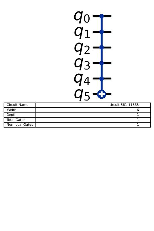

A gate representing the logical AND operation on a number of qubits.
For the AND operation the state ∣1⟩|1\rangle is interpreted as True. The result qubit is flipped, if the state of all variable qubits is True. In this format, the AND operation equals a multi-controlled X gate, which is controlled on all variable qubits. Using a list of flags however, qubits can be skipped or negated. Practically, the flags allow to skip controls or to apply pre- and post-X gates to the negated qubits.
The AndGate gate without special flags equals the multi-controlled-X gate:

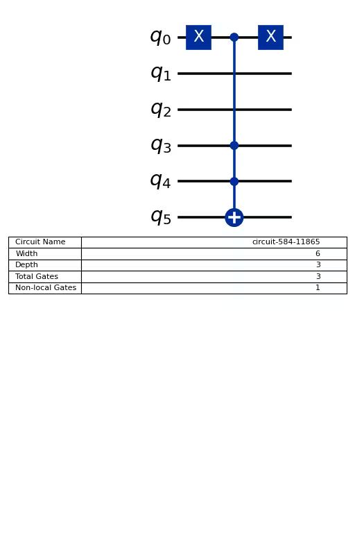

Using flags we can negate qubits or skip them. For instance, if we have 5 qubits and want to return True if the first qubit is False and the last two are True we use the flags [-1, 0, 0, 1, 1].
