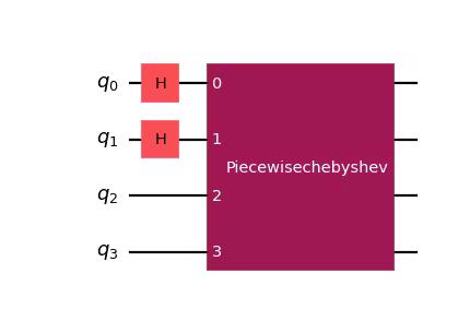

import numpy as np
from qiskit.circuit.library.arithmetic import PiecewiseChebyshevGate
f_x, num_state_qubits, degree, breakpoints = lambda x: np.arcsin(1 / x), 2, 2, [2, 4]
pw_approximation = PiecewiseChebyshevGate(f_x, num_state_qubits, degree, breakpoints)
qc = QuantumCircuit(pw_approximation.num_qubits)
qc.h(list(range(num_state_qubits)))
qc.append(pw_approximation, qc.qubits)
qc.draw(output="mpl")
Example of generating a circuit with the piecewise Chebyshev gate.
