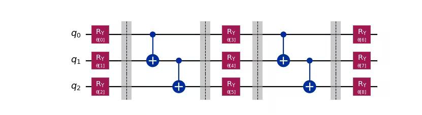

from qiskit.circuit.library import n_local
circuit = n_local(3, "ry", "cx", "linear", reps=2, insert_barriers=True)
circuit.draw("mpl")
Circuit diagram output by the previous code.

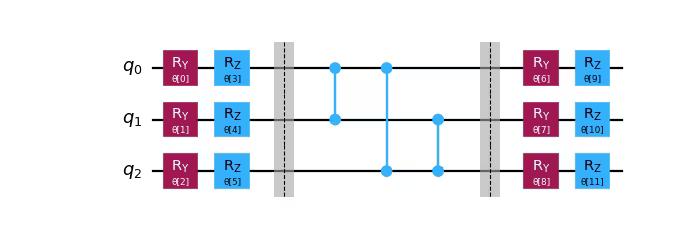

Multiple gates per layer can be set by passing a list. Here, for example, we use Pauli-Y and Pauli-Z rotations in the rotation layer:
circuit = n_local(3, ["ry", "rz"], "cz", "full", reps=1, insert_barriers=True)
circuit.draw("mpl")

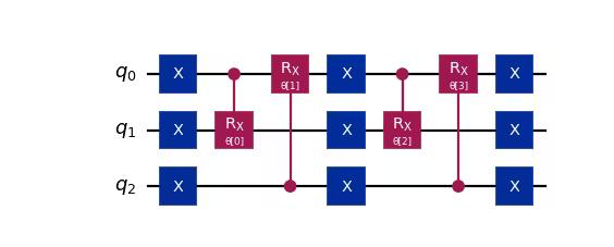

The entanglement can be set explicitly via the entanglement argument:
entangler_map = [[0, 1], [2, 0]]
circuit = n_local(3, "x", "crx", entangler_map, reps=2)
circuit.draw("mpl")

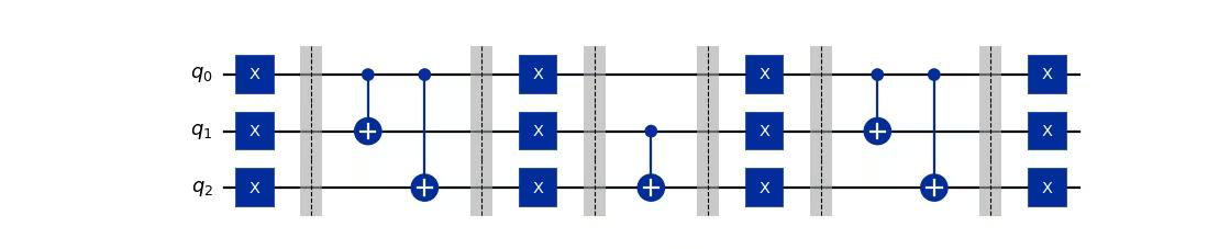

We can set different entanglements per layer, by specifing a callable that takes as input the current layer index, and returns the entanglement structure. For example, the following uses different entanglements for odd and even layers:
def entanglement(layer_index):
    if layer_index % 2 == 0:
        return [[0, 1], [0, 2]]
    return [[1, 2]]
circuit = n_local(3, "x", "cx", entanglement, reps=3, insert_barriers=True)
circuit.draw("mpl")
