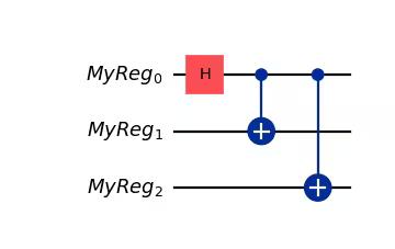

During the layout stage, the transpiler can potentially remap the order of the qubits in the circuit as it fits the circuit to the target backend. For example, let the input circuit be:
from qiskit.circuit import QuantumCircuit, QuantumRegister
qr = QuantumRegister(3, name="MyReg")
qc = QuantumCircuit(qr)
qc.h(0)
qc.cx(0, 1)
qc.cx(0, 2)
qc.draw("mpl")
Circuit diagram output by the previous code.

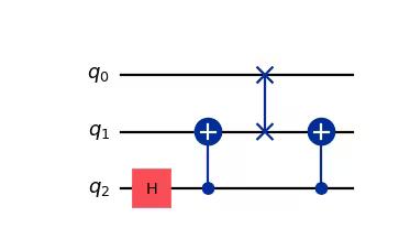

Building on the above example, suppose that during the routing stage the transpiler needs to insert swap gates, and the output circuit becomes:
qc = QuantumCircuit(3)
qc.h(2)
qc.cx(2, 1)
qc.swap(0, 1)
qc.cx(2, 1)
qc.draw("mpl")
Then the output of the routing_permutation() method is:
[1, 0, 2]
which maps positions of qubits before routing to their final positions after routing.
