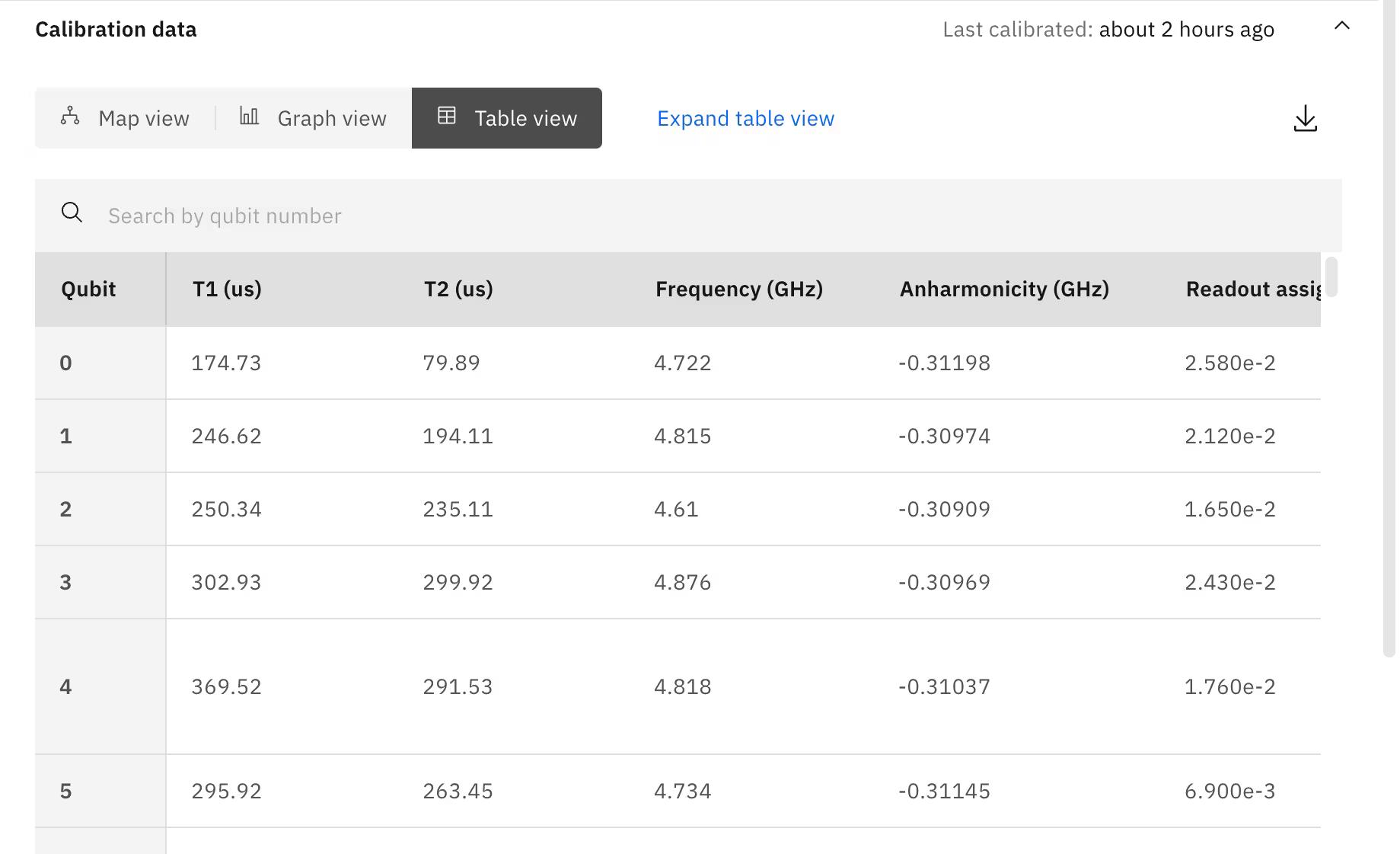

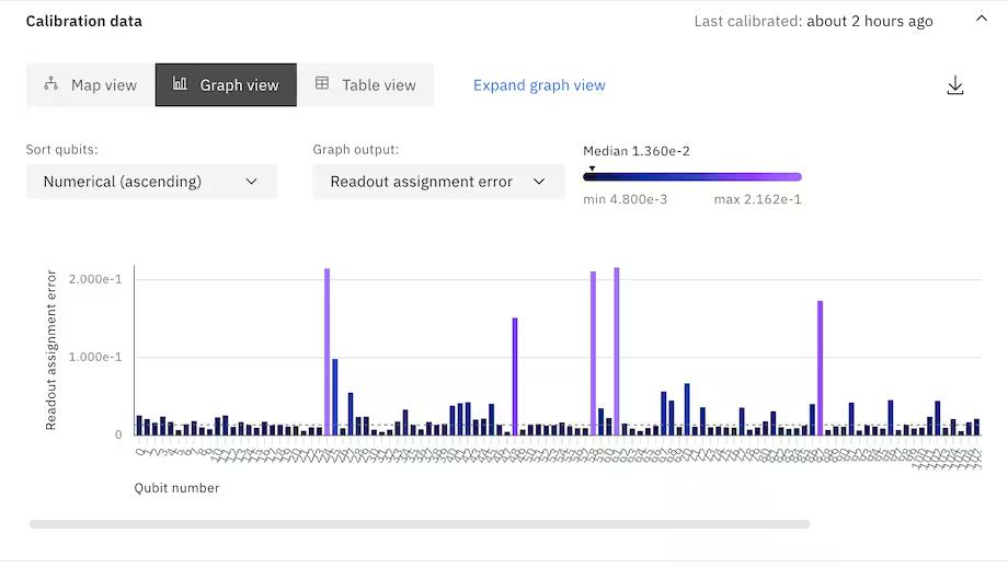

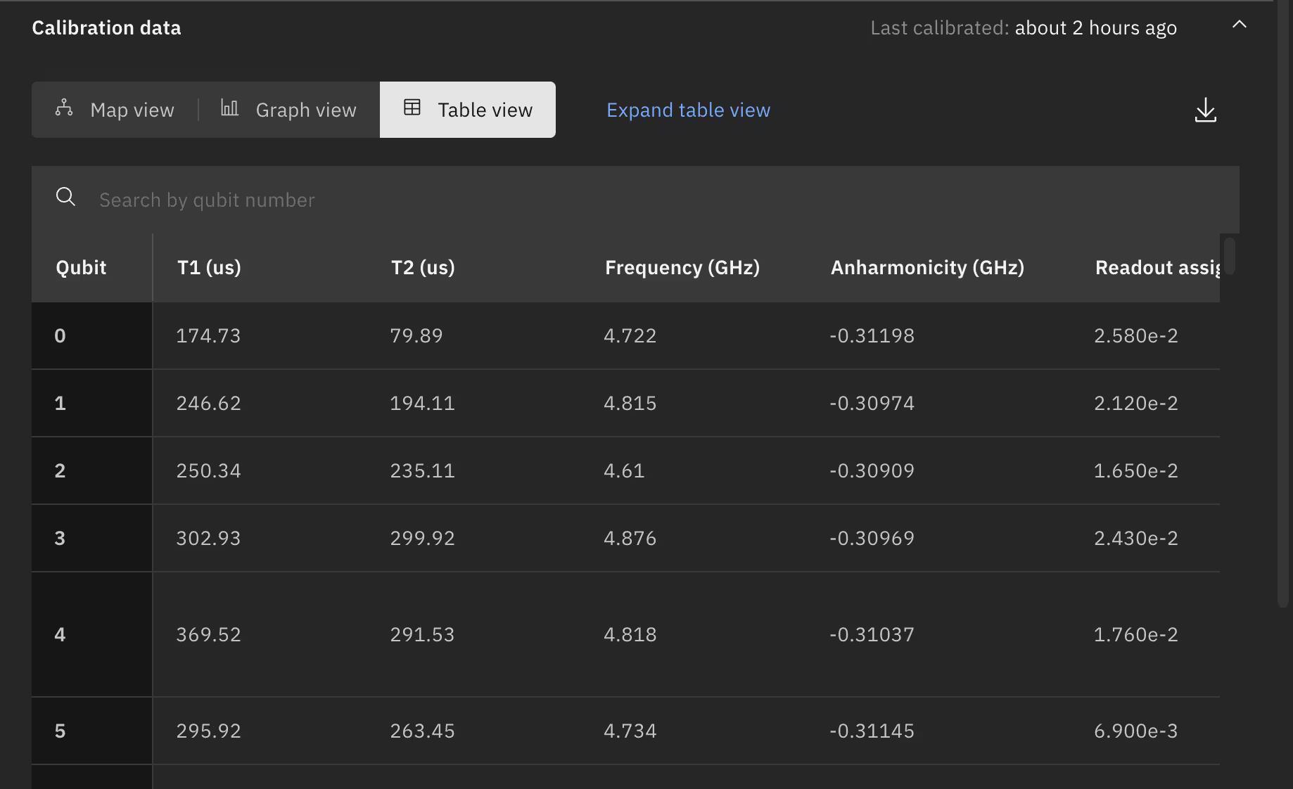

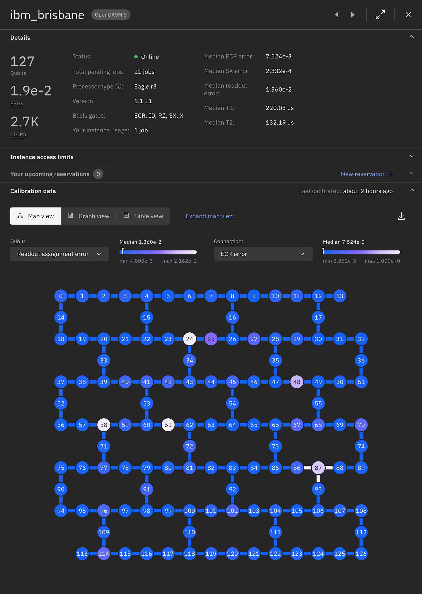

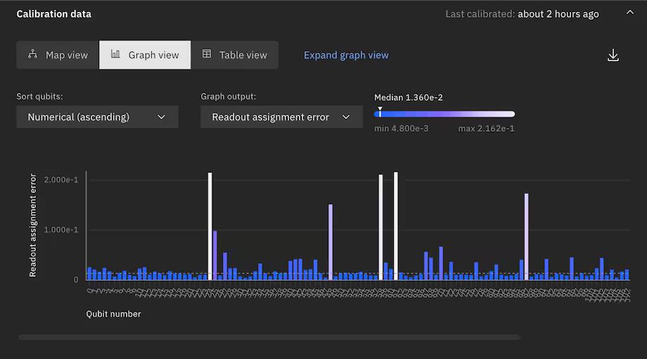

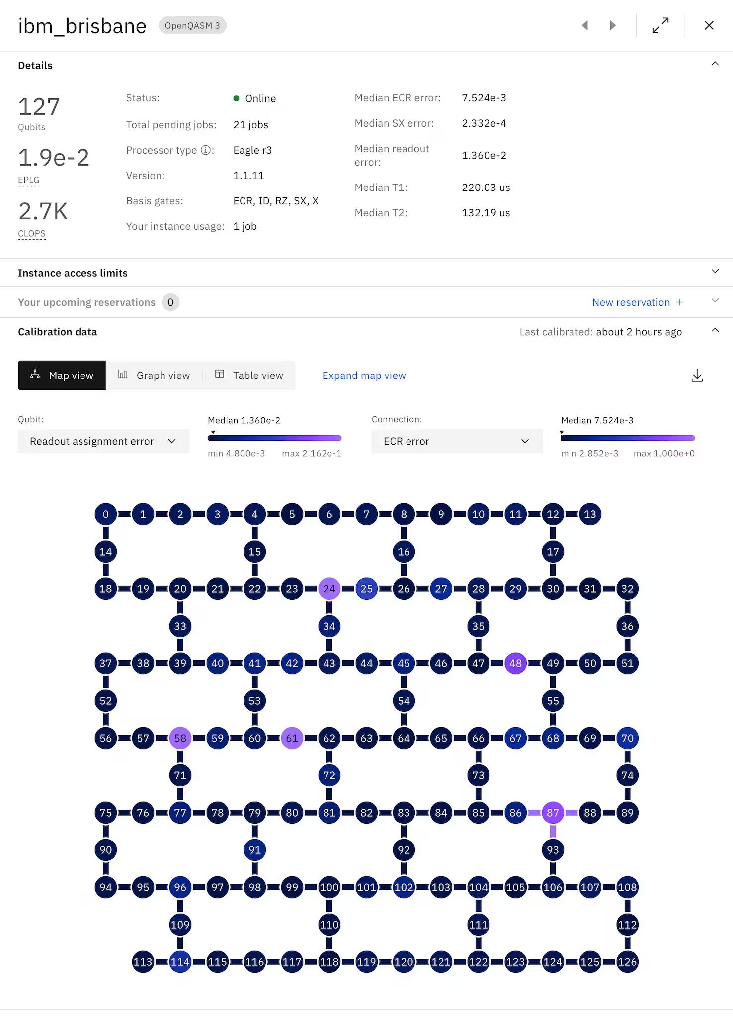

Dynamic backend information
Backends also have properties that change whenever the backend is calibrated, such as qubit lifetime and operation error rates. Backend properties update after the calibration sequence completes. These properties can be used when optimizing quantum circuits or to construct noise models for a classical simulator. See the Calibration jobs guide for more information.
On IBM Quantum Platform, you can download calibration data as a CSV file. Click a QPU on the Compute resources page to view its detailed information card, then click the download icon in the upper right corner of the Calibration data section.

    View on IBM Quantum Platform
    Calibration section: Qubit dropdown menu
  • The readout length specifies the duration of the readout operation for a qubit. It measures the time from the initiation of the measurement pulse to the completion of signal digitization, after which the system is ready for the next operation. Understanding this parameter is crucial for optimizing circuit execution, especially when incorporating mid-circuit measurements.
    View with Qiskit
    • For measure: backend.properties().readout_length(<qubit>)
    • For measure_2: backend.target['measure_2'][<qubit 1>, ].duration
    Calibration data section, Qubit dropdown menu
Additional properties
  • Maximum circuits per second (MCPS) includes measurement, reset, and reinitialization of a circuit with a Hadamard gate and a single measurement.
    View with Qiskit
    mcps = backend.configuration().mcps
    Details section
  • Circuit layer operations per second (CLOPS) is a measure of how many layers of a 100x100 circuit (hardware-aware circuit) a QPU can execute per unit of time.
    Calculate with Qiskit
    Find the CLOPS code in the Qiskit Community GitHub
    Details section
  • With BackendStatus, you can find the QPU status (for example, Active, Paused, Offline) as well as the number of pending jobs.
    View with Qiskit
    print(backend.status().status_msg), print(backend.status().pending_jobs)
    Details section
  • A diagram that indicates the pairs of qubits that support two-qubit gate operations between them. This is also called the coupling map or connectivity. Qubits are represented as circles and the supported two-qubit gate operations are displayed as lines connecting the qubits.
    View with Qiskit
    from qiskit.visualization import plot_gate_map then plot_gate_map(backend)
    Calibration data section; Click on Expand for a larger view
What does `error = 1` mean?
If the benchmarking of a qubit or edge does not succeed over the course of several days, whether due to poor data quality or other internal factors, the reported error value is considered stale and will be reported as 1. This is not an indication that the qubit or edge is necessarily non-working or that the error is 1; rather, the error is considered undefined and you should proceed with caution when operating that qubit or gate.
