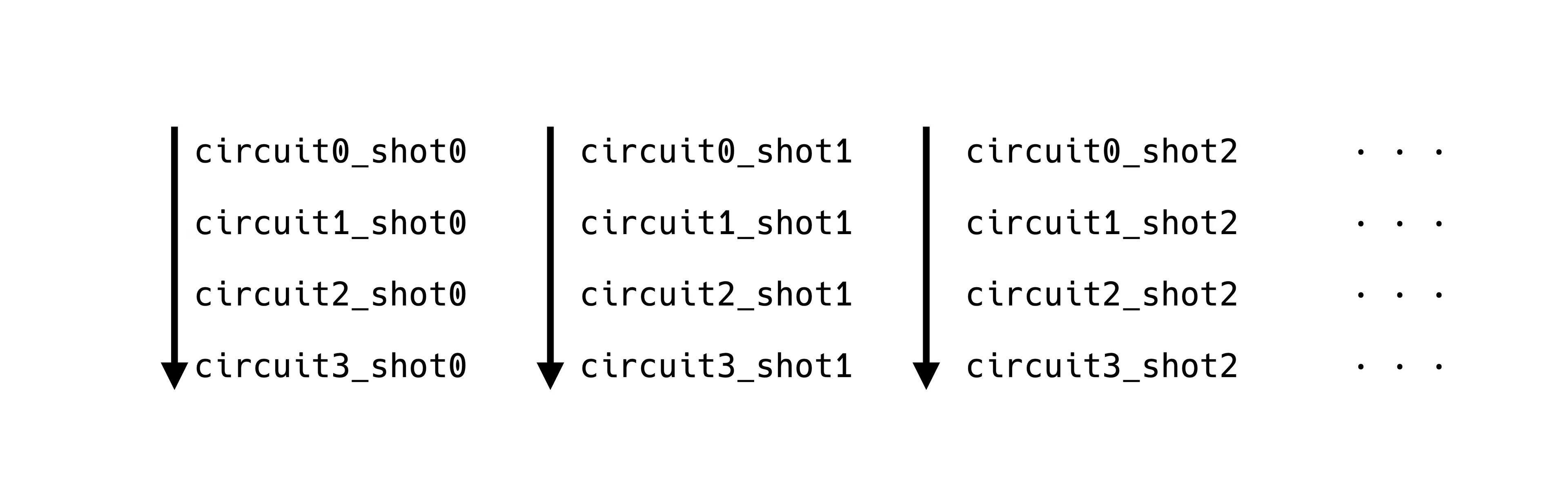

Because all IBM QPUs use dynamic repetition rate execution, you can change the rep_delay for each job. Circuits you submit in a primitive job are batched together for execution on the QPU. These circuits are executed by iterating over the circuits for each shot requested; the execution is column-wise over a matrix of circuits and shots, as illustrated in the following figure.
The first column represents shot 0.  The circuits are run in order from 0 through 3.  The second column represents shot 1.  The circuits are run in order from 0 through 3.  The remaining columns follow the same pattern.
Column-wise execution matrix

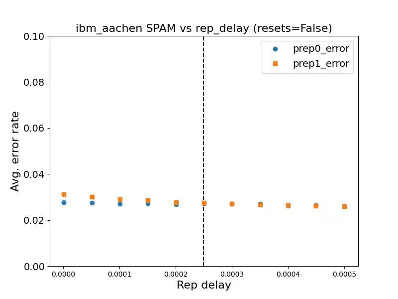

Because rep_delay is inserted between circuits, each shot of the execution encounters this delay. Therefore, as you lower the rep_delay, the total QPU execution time decreases, at the expense of increasing the state preparation error rate, as the following image illustrates:
This image shows that as the rep_delay value is lowered, the state preparation error rate increases.
Repetition delay versus error rate
