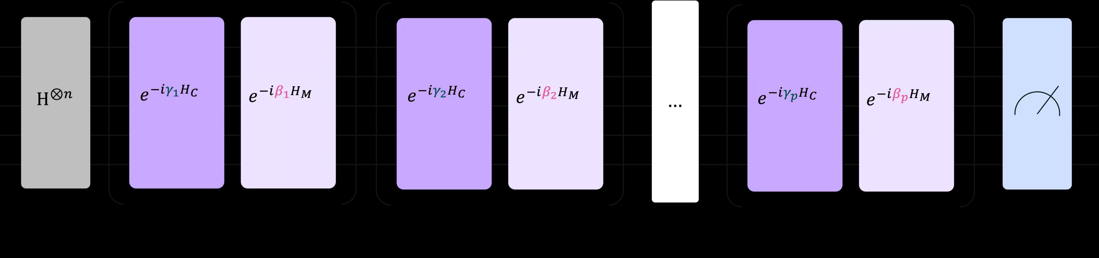

QAOA prepares candidate solutions by applying alternating layers of two operators to an initial superposition state Hn0H^{\otimes n}|0\rangle: the cost operator eiγkHCe^{-i\gamma_k H_C} and a mixer operator eiβkHme^{-i\beta_k H_m}. The angles γk\gamma_k and βk\beta_k are optimized in a classical feedback loop; the quantum computer evaluates the cost function, and a classical optimizer updates the parameters until convergence. This iterative loop runs within a Quantum Compute session, which keeps the quantum device reserved across iterations for lower latency.
Circuit diagram with QAOA layers

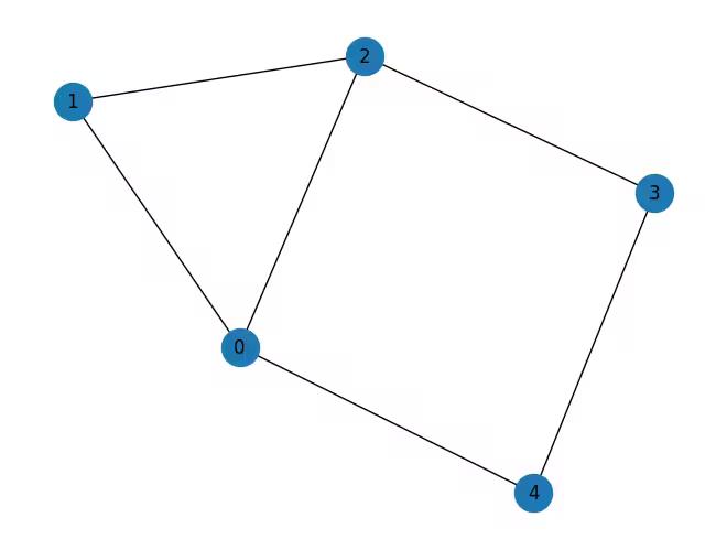

This section walks through each step of the QAOA workflow on a small five-node max-cut instance. Despite the "small-scale" label, this example still runs on real IBM Quantum hardware — the code selects a backend with 127 or more qubits and executes the circuit there.
Initialize your problem by creating a graph with n=5n=5 nodes.
n_small = 5
graph = rx.PyGraph()
graph.add_nodes_from(np.arange(0, n_small, 1))
edge_list = [
    (0, 1, 1.0),
    (0, 2, 1.0),
    (0, 4, 1.0),
    (1, 2, 1.0),
    (2, 3, 1.0),
    (3, 4, 1.0),
graph.add_edges_from(edge_list)
draw_graph(graph, node_size=600, with_labels=True)

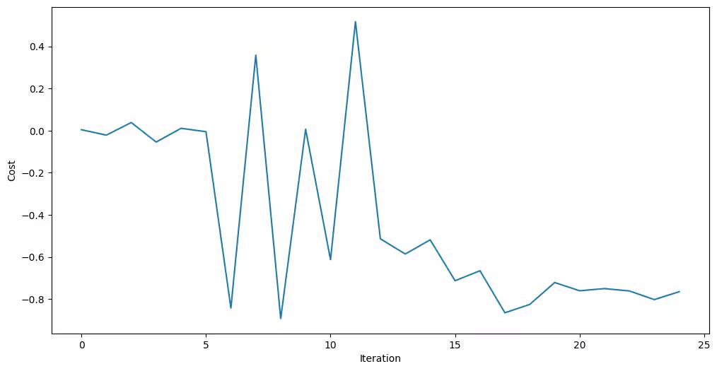

The optimizer was able to reduce the cost and find better parameters for the circuit.
A smoothly decreasing curve that plateaus is the signature of convergence. A noisy, non-monotonic curve usually indicates that something upstream needs attention; common causes are too few shots per evaluation (high estimator variance), poor initial parameters, or a circuit whose depth is dominated by hardware noise. COBYLA is derivative-free and fairly robust to moderate noise, but when the noise swamps the actual cost improvements per step, its linear-approximation model can no longer tell real descent from random jitter and the optimizer wanders.
plt.figure(figsize=(12, 6))
plt.plot(objective_func_vals)
plt.xlabel("Iteration")
plt.ylabel("Cost")
plt.show()

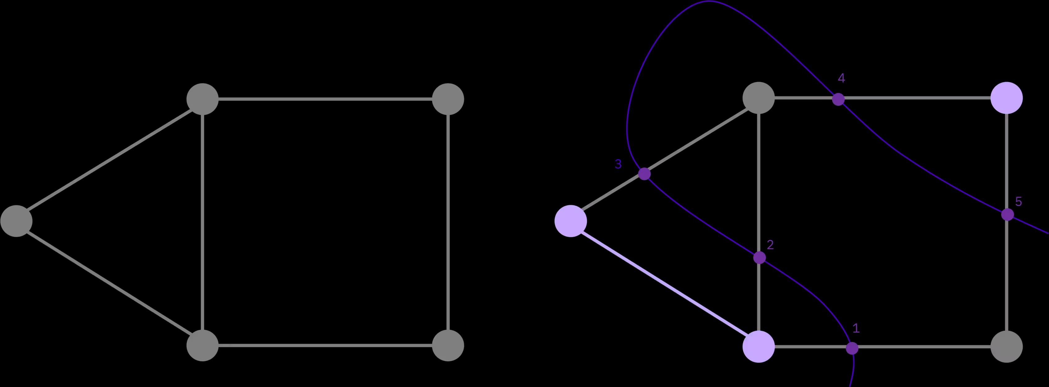

plot_result(graph, most_likely_bitstring)
Output:
Output of the previous code cell
Now, calculate the value of the cut:
def evaluate_sample(x: Sequence[int], graph: rx.PyGraph) -> float:
    assert len(x) == len(
        list(graph.nodes())
    ), "The length of x must coincide with the number of nodes in the graph."
    return sum(
        x[u] * (1 - x[v]) + x[v] * (1 - x[u])
        for u, v in list(graph.edge_list())
cut_value = evaluate_sample(most_likely_bitstring, graph)
print("The value of the cut is:", cut_value)
Output:
The value of the cut is: 5

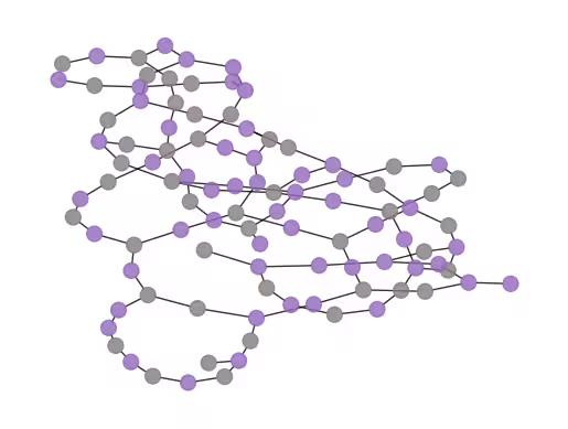

Step 1: Build the graph, cost Hamiltonian, and ansatz.
# Step 1: build the 100-node graph, cost Hamiltonian, and QAOA ansatz.
n_large = 100
graph_100 = rx.PyGraph()
graph_100.add_nodes_from(np.arange(0, n_large, 1))
elist = []
for edge in backend.coupling_map:
    if edge[0] < n_large and edge[1] < n_large:
        elist.append((edge[0], edge[1], 1.0))
graph_100.add_edges_from(elist)
max_cut_paulis_100 = build_max_cut_paulis(graph_100)
cost_hamiltonian_100 = SparsePauliOp.from_sparse_list(
    max_cut_paulis_100, n_large
circuit_100 = QAOAAnsatz(cost_operator=cost_hamiltonian_100, reps=1)
circuit_100.measure_all()

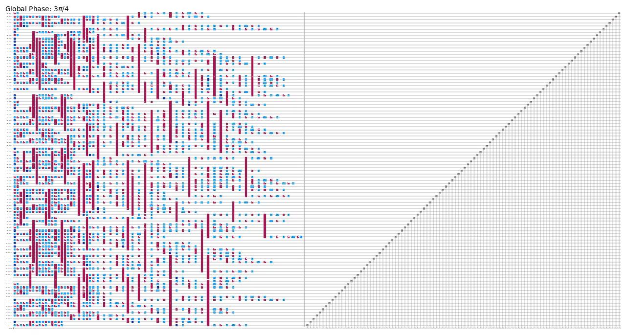

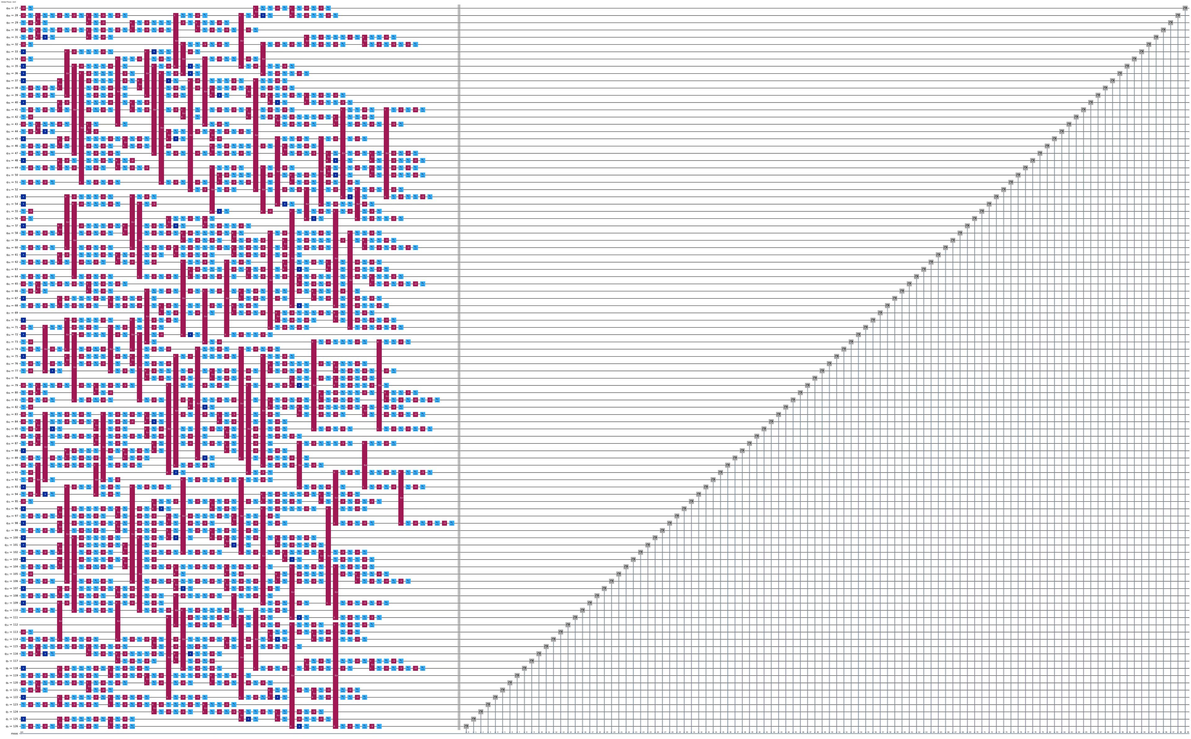

Step 2: Transpile for the selected hardware backend.
# Step 2: transpile for hardware.
pm = generate_preset_pass_manager(optimization_level=3, backend=backend)
candidate_circuit_100 = pm.run(circuit_100)

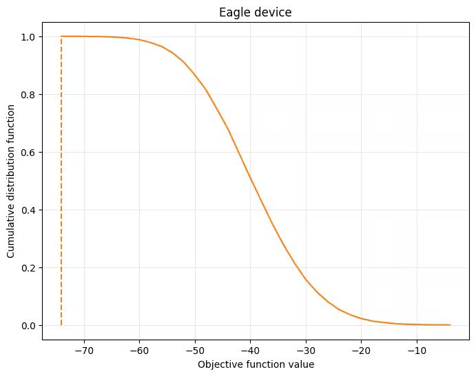

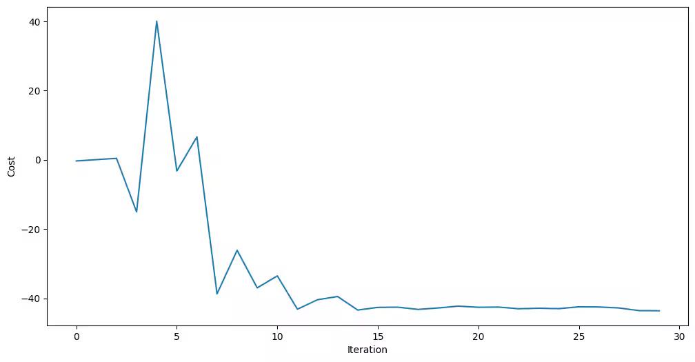

Check that the cost minimized in the optimization loop has converged, and visualize results.
# Plot convergence
plt.ylabel("Cost")
plt.show()

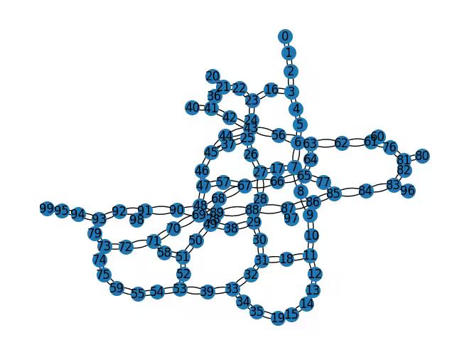

# Visualize the cut
plot_result(graph_100, best_sol_bitstring_100)
# Plot cumulative distribution function
result_dist = samples_to_objective_values(
    final_distribution_100_int, cost_hamiltonian_100
fig, ax = plt.subplots(1, 1, figsize=(8, 6))
plot_cdf(result_dist, ax, backend.name)
Output:
Output of the previous code cell Output of the previous code cell Output of the previous code cell
