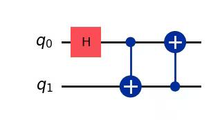

The process of transpilation takes a circuit that contains your instructions:
A two-qubit quantum circuit containing a Hadamard and two CNOT gates.
Quantum circuit

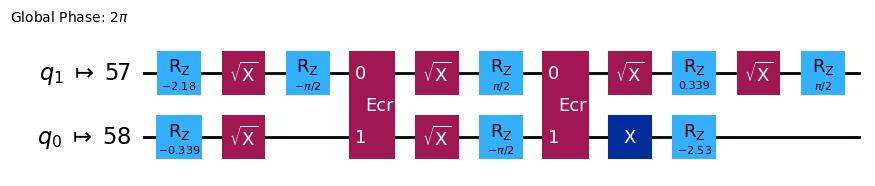

Transpilation then transforms it such that only instructions available on a chosen backend are used, and optimizes those instructions to minimize the effects of noise:
The same two-qubit quantum circuit after transpilation.  It contains RZ, X, SX, and ECR gates.
Quantum circuit after transpilation
