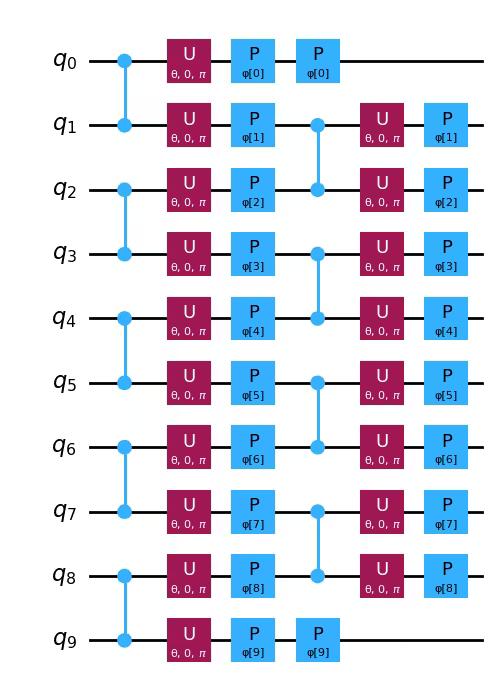

num_qubits = 10
depth = 2
mbl = MBLChainCircuit(num_qubits, depth)
mbl.draw("mpl", fold=-1)
Output:
Output of the previous code cell

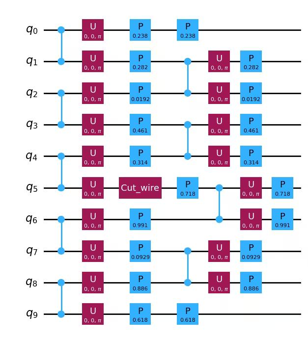

The circuit needs to be annotated by inserting CutWire in the desired locations to partition it. For this tutorial, we opt for equal partition. The MBL circuit is designed so that setting use_cut=True in the function inserts the annotation properly after n2\frac{n}{2} qubits, nn being the number of qubits in the original circuit. We also assigned the randomly generated parameters to the circuit.
mbl_cut = MBLChainCircuit(num_qubits, depth, use_cut=True)
mbl_cut.assign_parameters(params, inplace=True)
mbl_cut.draw("mpl", fold=-1)
Output:

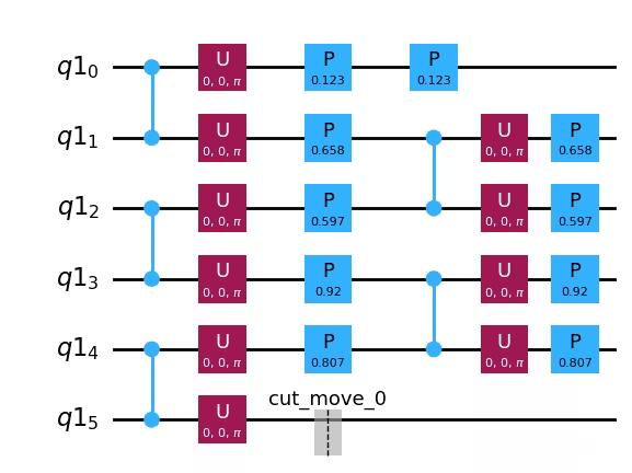

Now we partition the circuit into two smaller subcircuits using qiskit-addon-cutting. qiskit-addon-cutting appends a virtual Move gate to split the wire cut location by appropriately adjusting the number of qubits. Now we create the circuit with this virtual gate. Since there is one wire cut, the number of associated qubits will be increased by 1.
mbl_move = cut_wires(mbl_cut)
mbl_move.draw("mpl", fold=-1)
Output:

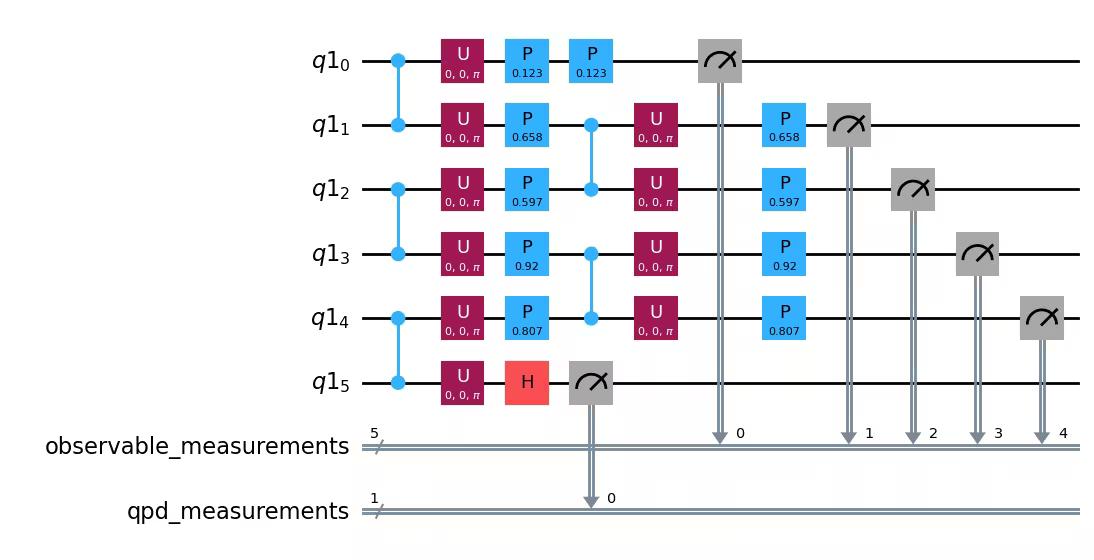

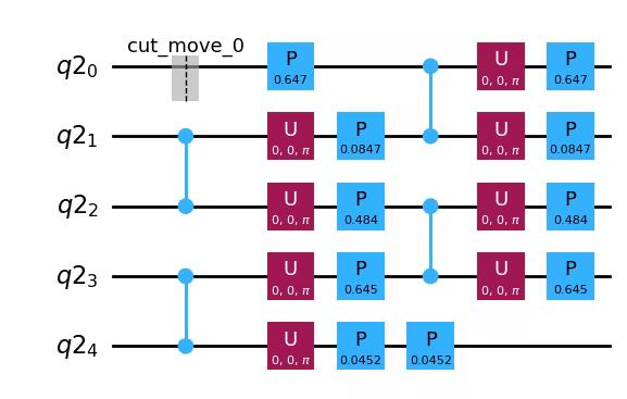

Now the circuit can be partitioned along the Move gate and we obtain the subcircuits, as well as the subobservable, which is the portion of the original observable associated with each subcircuit.
partitioned_problem = partition_problem(circuit=mbl_move, observables=new_obs)
subcircuits = partitioned_problem.subcircuits
subobservables = partitioned_problem.subobservables

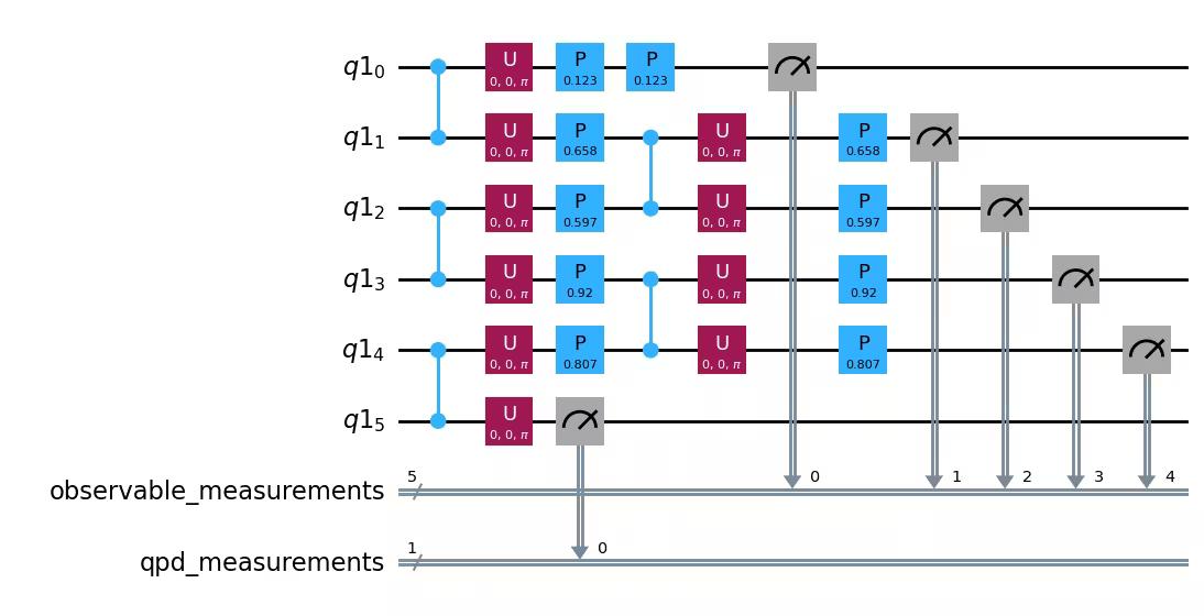

Here we visualize the two subcircuits:
subcircuits[0].draw("mpl", fold=-1)
Output:
subcircuits[1].draw("mpl", fold=-1)
Output:

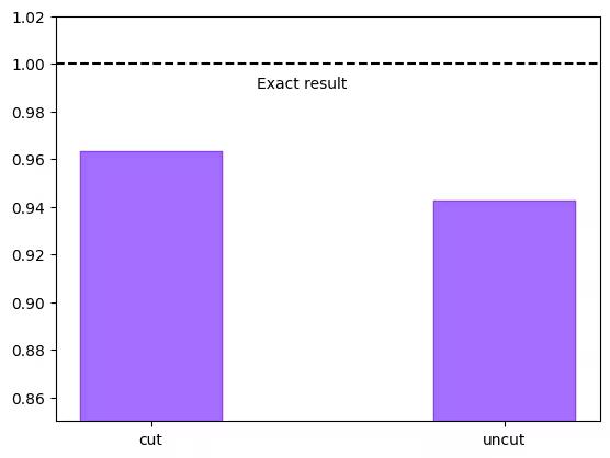

Large-scale hardware example
Now we demonstrate wire cutting for a 60-qubit MBL circuit. The uncut, as well as the cut circuits, will be executed on IBM Quantum® hardware:
num_qubits = 60
depth = 2
# construct the circuit
# create parameters
phis = list(np.random.rand(mbl.num_parameters - 1))
theta = [0]
params = theta + phis
# construct the cut circuit
# Define observable and expand to account for the wire cut
observable = PauliList(
    ["I" * i + "Z" + "I" * (num_qubits - i - 1) for i in range(num_qubits)]
new_obs = expand_observables(observable, mbl, mbl_move)
# Construct a SparsePauliOp version of the observable for later use in reconstruction
M_z = SparsePauliOp(
    ["I" * i + "Z" + "I" * (num_qubits - i - 1) for i in range(num_qubits)],
    coeffs=[1 / num_qubits] * num_qubits,
# Partition the circuit and get subcircuits and subobservables
# Obtain subexperiments and coefficients
subexperiments, coefficients = generate_cutting_experiments(
    circuits=subcircuits,
    observables=subobservables,
    num_samples=np.inf,
# Transpile the subexperiments to the backend
pm = generate_preset_pass_manager(optimization_level=2, backend=backend)
isa_subexperiments = {
    label: pm.run(partition_subexpts)
    for label, partition_subexpts in subexperiments.items()
# Execute the subexperiments and retrieve results
with Batch(backend=backend) as batch:
    sampler = SamplerV2(mode=batch)
    sampler.options.environment.job_tags = ["TUT_WC"]
    jobs = {
        label: sampler.run(subsystem_subexpts, shots=2**12)
        for label, subsystem_subexpts in isa_subexperiments.items()
results = {label: job.result() for label, job in jobs.items()}
# Reconstruct the expectation value of the original observable
reconstructed_expval_terms = reconstruct_expectation_values(
    results,
    coefficients,
    subobservables,
reconstructed_expval = np.dot(reconstructed_expval_terms, M_z.coeffs).real
# Compute the uncut circuit to obtain the noisy expectation value for comparison
sampler = SamplerV2(mode=backend)
if mbl.num_clbits == 0:
    mbl.measure_all()
isa_mbl = pm.run(mbl)
pub = (isa_mbl, params)
uncut_job = sampler.run([pub])
uncut_counts = uncut_job.result()[0].data.meas.get_counts()
uncut_expval = sampled_expectation_value(uncut_counts, M_z)
# visualize the results
ax = plt.gca()
methods = ["uncut", "cut"]
values = [uncut_expval, reconstructed_expval]
plt.bar(methods, values, color="#a56eff", width=0.4, edgecolor="#8a3ffc")
plt.axhline(y=1, color="k", linestyle="--")
plt.text(0.3, 0.95, "Exact result")
plt.show()
Output:
uncut_expval
Output:
0.9202473958333336
