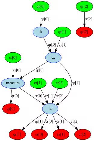

    Use the qiskit.tools.visualization.dag_drawer() function to view this circuit's DAG. There are three kinds of graph nodes: qubit/clbit nodes (green), operation nodes (blue), and output nodes (red). Each edge indicates data flow (or dependency) between two nodes.

    The circuit's DAG consists of nodes that are connected by directional edges. It is a visual way to represent qubits or classical bits, the operations, and the way that data flows.
    DAG
