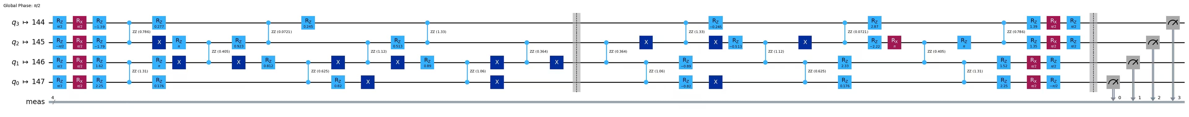

Quantum kernel circuits and their corresponding parameter values are generated for systems with 4 to 40 qubits, and their fidelities are subsequently evaluated.
qubits = list(range(4, 12, 2))
circuits = [quantum_kernel(i, reps=reps) for i in qubits]
params = [random_parameters(circ) for circ in circuits]
The four-qubit circuit is visualized below.
circuits[0].draw("mpl", fold=-1)

Step 2: Optimize problem for quantum hardware execution
We then transpile the circuit using the pass manager following the standard Qiskit pattern. By providing a backend that supports fractional gates to generate_preset_pass_manager, a specialized pass called FoldRzzAngle is automatically included. This pass modifies the circuit to comply with the RZZ angle constraints. As a result, RZZ gates with negative values in the previous figure are transformed into positive values, and some additional X gates are added.
backend_f = service.backend(name=backend_name, use_fractional_gates=True)
# pm_f includes `FoldRzzAngle` pass
pm_f = generate_preset_pass_manager(
    optimization_level=optimization_level, backend=backend_f
pm_f.post_optimization = PassManager(
        FoldRzzAngle(),
        Optimize1qGatesDecomposition(target=backend_f.target),
        RemoveIdentityEquivalent(target=backend_f.target),
t_qc_f = pm_f.run(b_qc)
print(t_qc_f[0].count_ops())
t_qc_f[0].draw("mpl", fold=-1)
Output:
OrderedDict({'rz': 35, 'rzz': 18, 'x': 13, 'rx': 9, 'measure': 4, 'barrier': 2})
Output of the previous code cell

We use a circuit consisting of U, CZ, and RZZ gates as an example.
qc = n_local(3, "u", "cz", "linear", reps=1)
qc.rzz(1.1, 0, 1)
qc.draw("mpl")
Output:
We first transpile the circuit for a backend that does not support fractional gates.
pm_c = generate_preset_pass_manager(
    optimization_level=optimization_level, backend=backend_c
t_qc = pm_c.run(qc)
print(t_qc.count_ops())
t_qc.draw("mpl")
Output:
OrderedDict({'rz': 23, 'sx': 16, 'cz': 4})
Then, we transpile the same circuit using fractional RX gates, while excluding RZZ gates. This results in a slight reduction in the total gate count, thanks to the more efficient implementation of the RX gates.
backend_f = service.backend(backend_name, use_fractional_gates=True)
target = remove_instruction_from_target(backend_f.target, "rzz")
    target=target,
t_qc = pm_f.run(qc)
t_qc.draw("mpl")
Output:
OrderedDict({'rz': 22, 'sx': 14, 'cz': 4, 'rx': 1})
Optimize U gates with fractional RX gates
In this section, we demonstrate how to optimize U gates using fractional RX gates, building on the same circuit introduced in the previous section.
We transpile the circuit using only fractional RX gates, excluding RZZ gates. By introducing a custom decomposition rule, as shown in the following, we can reduce the number of single-qubit gates required to implement a U gate.
This feature is currently under discussion in this GitHub issue.
# special decomposition rule for UGate
x = ParameterVector("x", 3)
zxz = QuantumCircuit(1)
zxz.rz(x[2] - np.pi / 2, 0)
zxz.rx(x[0], 0)
zxz.rz(x[1] + np.pi / 2, 0)
DEFAULT_EQUIVALENCE_LIBRARY.add_equivalence(UGate(x[0], x[1], x[2]), zxz)
Next, we apply the transpiler using constructor-beta translation provided by the qiskit-basis-constructor package. As a result, the total number of gates is reduced compared to the previous transpilation.
    target=target,
    translation_method="constructor-beta",
t_qc = pm_f.run(qc)
t_qc.draw("mpl")
Output:
OrderedDict({'rz': 16, 'rx': 9, 'cz': 4})
