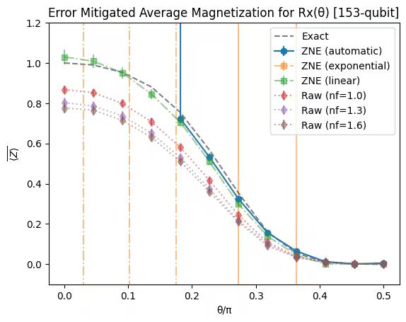

"""Result visualization functions"""
def plot_trotter_results(
    pub_result: PubResult,
    angles: Sequence[float],
    plot_noise_factors: Sequence[float] | None = None,
    plot_extrapolator: Sequence[str] | None = None,
    exact: np.ndarray = None,
    close: bool = True,
    """Plot average magnetization from ZNE result data.
    Args:
        pub_result: The Estimator PubResult for the PEA experiment.
        angles: The Rx angle values for the experiment.
        plot_raw: If provided plot the unextrapolated data for the noise factors.
        plot_extrapolator: If provided plot all extrapolators, if False only plot
            the Automatic method.
        exact: Optional, the exact values to include in the plot. Should be a 1D
            array-like where the values represent exact magnetization.
        close: Close the Matplotlib figure before returning.
    Returns:
        The figure.

    fig, _ = plt.subplots(1, 1)
    # Plot auto method
    plt.errorbar(x_vals, y_vals, y_errs, fmt="o-", label="ZNE (automatic)")
    # Plot individual extrapolator results
    if plot_extrapolator:
        y_vals_extrap = np.mean(data.evs_extrapolated, axis=0)
        y_errs_extrap = np.std(data.evs_extrapolated, axis=0) / np.sqrt(
            num_qubits
        for i, extrap in enumerate(plot_extrapolator):
            plt.errorbar(
                x_vals,
                y_vals_extrap[:, i, 0],
                y_errs_extrap[:, i, 0],
                fmt="s-.",
                alpha=0.5,
                label=f"ZNE ({extrap})",
    # Plot raw results
    if plot_noise_factors:
        y_vals_raw = np.mean(data.evs_noise_factors, axis=0)
        y_errs_raw = np.std(data.evs_noise_factors, axis=0) / np.sqrt(
            num_qubits
        for i, nf in enumerate(plot_noise_factors):
            plt.errorbar(
                x_vals,
                y_vals_raw[:, i],
                y_errs_raw[:, i],
                fmt="d:",
                alpha=0.5,
                label=f"Raw (nf={nf:.1f})",
    # Plot exact data
    if exact is not None:
        plt.plot(x_vals, exact, "--", color="black", alpha=0.5, label="Exact")
    plt.ylim(-0.1, 1.2)
    plt.xlabel("θ/π")
    plt.ylabel(r"$\overline{\langle Z \rangle}$")
    plt.legend()
    plt.title(
        f"Error Mitigated Average Magnetization for Rx(θ) [{num_qubits}-qubit]"
    if close:
        plt.close(fig)
    return fig

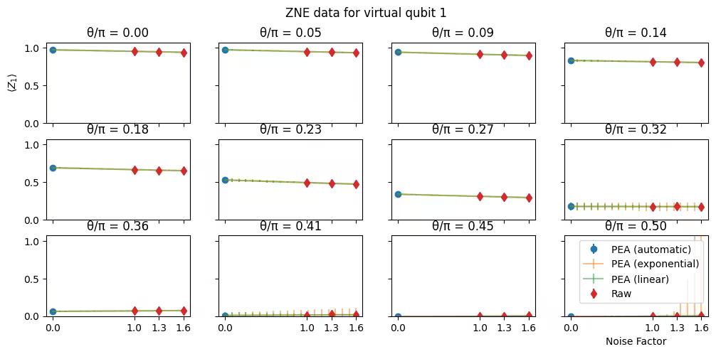

def plot_qubit_zne_data(
    qubit: int,
    noise_factors: Sequence[float],
    extrapolated_noise_factors: Sequence[float] | None = None,
    num_cols: int | None = None,
    close: bool = True,
    """Plot ZNE extrapolation data for specific virtual qubit
    Args:
        angles: The Rx theta angles used for the experiment.
        qubit: The virtual qubit index to plot.
        noise_factors: the raw noise factors.
        extrapolator: The extrapolator metadata for multiple extrapolators.
        extrapolated_noise_factors: The noise factors used for extrapolation.
        num_cols: The number of columns for the generated subplots.
    Returns:
        The Matplotlib figure.
    data = pub_result.data
    evs_auto = data.evs[qubit]
    stds_auto = data.stds[qubit]
    evs_extrap = data.evs_extrapolated[qubit]
    stds_extrap = data.stds_extrapolated[qubit]
    evs_raw = data.evs_noise_factors[qubit]
    stds_raw = data.stds_noise_factors[qubit]
    num_params = evs_auto.shape[0]
    angles = np.asarray(angles).ravel()
    if angles.shape != (num_params,):
        raise ValueError(
            f"Incorrect number of angles for input data {angles.size} != {num_params}"
    # Make a square subplot
    num_cols = num_cols or int(np.ceil(np.sqrt(num_params)))
    num_rows = int(np.ceil(num_params / num_cols))
    fig, axes = plt.subplots(
        num_rows, num_cols, sharex=True, sharey=True, figsize=(12, 5)
    fig.suptitle(f"ZNE data for virtual qubit {qubit}")
    for pidx, ax in zip(range(num_params), axes.flat):
        # Plot auto extrapolated
        ax.errorbar(
            0,
            evs_auto[pidx],
            stds_auto[pidx],
            fmt="o",
            label="PEA (automatic)",
        # Plot extrapolators
        if (
            extrapolator is not None
            and extrapolated_noise_factors is not None
            for i, method in enumerate(extrapolator):
                ax.errorbar(
                    extrapolated_noise_factors,
                    evs_extrap[pidx, i],
                    stds_extrap[pidx, i],
                    fmt="-",
                    alpha=0.5,
                    label=f"PEA ({method})",
        # Plot raw
        ax.errorbar(
            noise_factors, evs_raw[pidx], stds_raw[pidx], fmt="d", label="Raw"
        ax.set_yticks([0, 0.5, 1, 1.5, 2])
        ax.set_ylim(0, max(1, 1.1 * max(evs_auto)))
        ax.set_xticks([0, *noise_factors])
        ax.set_title(f"θ/π = {angles[pidx]/np.pi:.2f}")
        if pidx == 0:
            ax.set_ylabel(r"$\langle Z_{" + str(qubit) + r"} \rangle$")
        if pidx == num_params - 1:
            ax.set_xlabel("Noise Factor")
            ax.legend()
    plt.tight_layout()
    if close:
        plt.close(fig)
    return fig

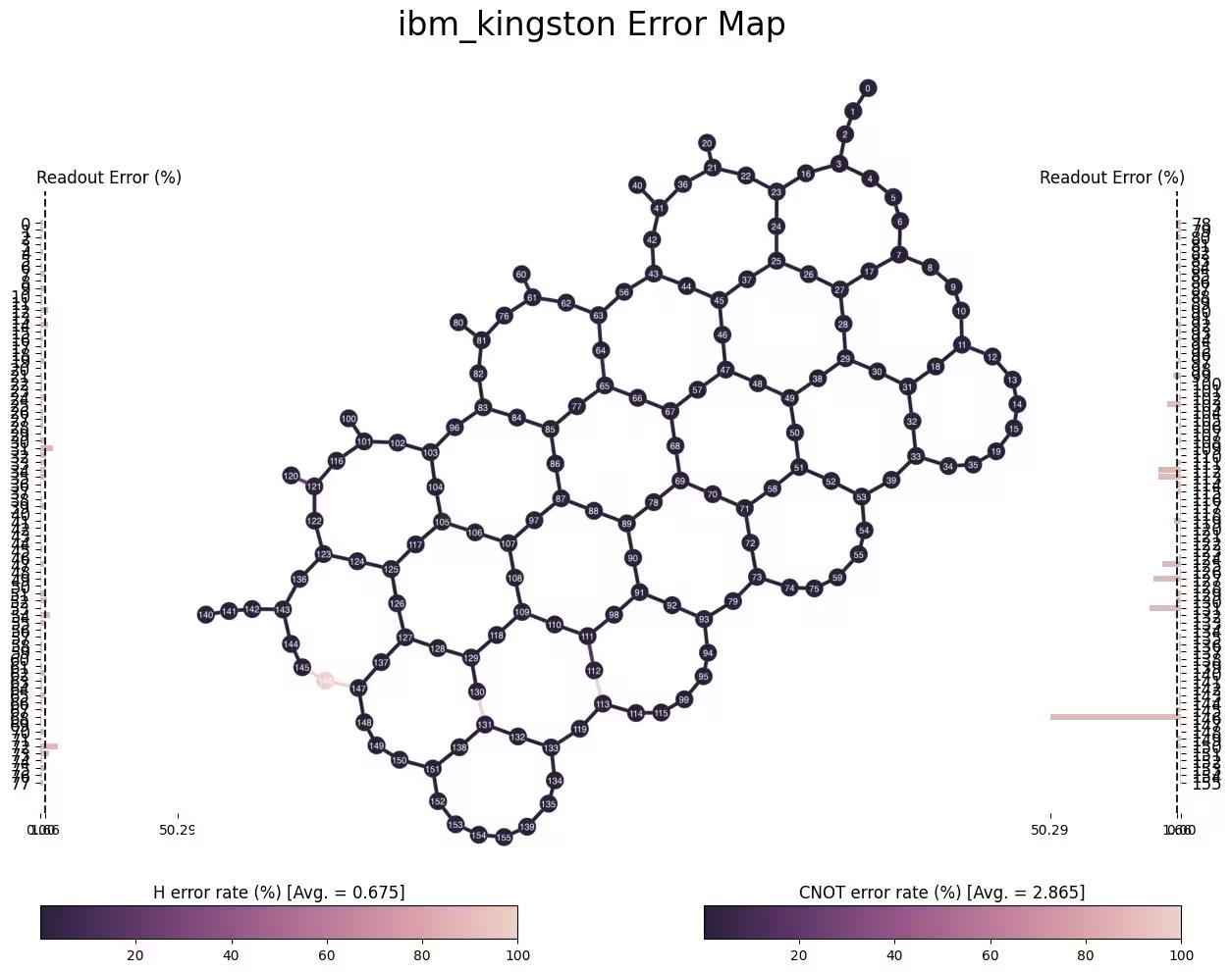

Remove bad qubits
Look at the coupling map for the backend and see if any qubits connect to couplings with high error. Remove these "bad" qubits from your experiment.
# Plot gate error map
# NOTE: These can change over time, so your results may look different
plot_error_map(backend)
Output:
Output of the previous code cell
bad_qubits = {
    32,
    33,
    71,
    72,
    73,
    102,
    103,
}  # qubits removed based on high coupling error (1.00)

Plot Trotter simulation results
The following code creates a plot to compare the raw and mitigated experiment results against the exact solution.
zne_metadata = primitive_result.metadata["resilience"]["zne"]
# Plot Trotter simulation results
fig = plot_trotter_results(
    pub_result,
    parameter_values,
    plot_extrapolator=zne_metadata["extrapolator"],
    plot_noise_factors=zne_metadata["noise_factors"],
    exact=exact_data,
display(fig)
Output:
While the noisy (noise factor nf=1.0) values show high deviation from exact values, the mitigated values are close to exact values, demonstrating the utility of the PEA-based mitigation technique.
Plot extrapolation results for individual qubits
Finally, the following code creates a plot to show the extrapolation curves for different values of theta on a specific qubit.
virtual_qubit = 1
    pub_result=pub_result,
    angles=parameter_values,
    qubit=virtual_qubit,
    extrapolated_noise_factors=zne_metadata["extrapolated_noise_factors"],
Output:
