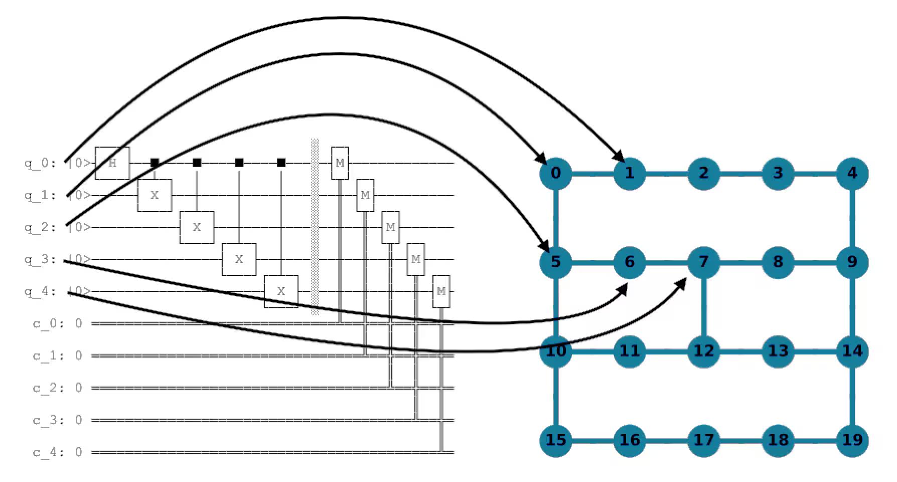

The next stage involves the layout or connectivity of the backend a circuit will be sent to. In general, quantum circuits are abstract entities whose qubits are "virtual" or "logical" representations of actual qubits used in computations. To execute a sequence of gates, a one-to-one mapping from the "virtual" qubits to the "physical" qubits in an actual quantum device is necessary. This mapping is stored as a Layout object and is part of the constraints defined within a backend's instruction set architecture (ISA).
This image illustrates qubits being mapped from the wire representation to a diagram that represents how the qubits are connected on the QPU.
Qubit mapping
The choice of mapping is extremely important for minimizing the number of SWAP operations needed to map the input circuit onto the device topology and ensure the most well-calibrated qubits are used. Due to the importance of this stage, the preset pass managers try a few different methods to find the best layout. Typically this involves two steps: first, try to find a "perfect" layout (a layout that does not require any SWAP operations), and then, a heuristic pass that tries to find the best layout to use if a perfect layout cannot be found. There are two Passes typically used for this first step:

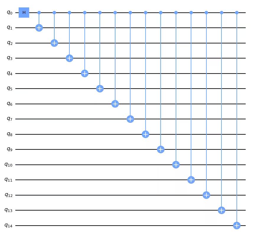

15-qubit GHZ state
15-qubit GHZ state before transpilation
The following code constructs a 15-qubit GHZ state and compares the optimization_levels of transpilation in terms of resulting circuit depth, gate counts, and multi-qubit gate counts.
ghz = QuantumCircuit(15)
ghz.h(0)
ghz.cx(0, range(1, 15))

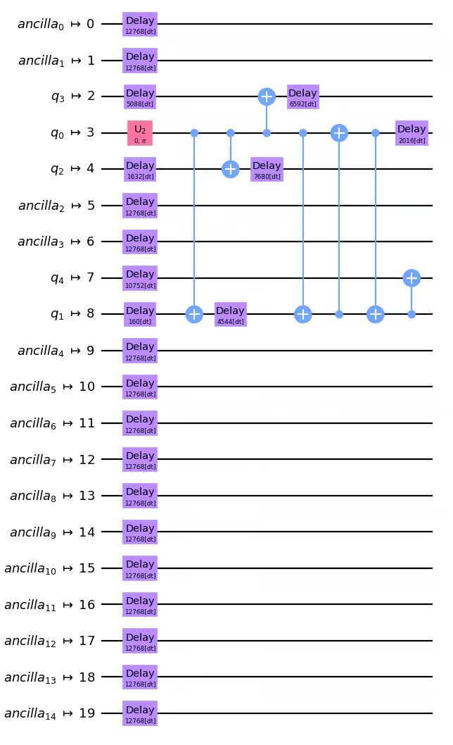

Scheduling
This last stage is only run if it is explicitly called for (similar to the Init stage) and does not run by default (though a method can be specified by setting the scheduling_method argument when calling generate_preset_pass_manager). The scheduling stage is typically used once the circuit has been translated to the target basis, mapped to the device, and optimized. These passes focus on accounting for all the idle time in a circuit. At a high level, the scheduling pass can be thought of as explicitly inserting delay instructions to account for the idle time between gate executions and to inspect how long the circuit will be running on the backend.
Here is an example:
ghz = QuantumCircuit(5)
ghz.h(0)
ghz.cx(0, range(1, 5))
# Use fake backend
backend = GenericBackendV2(5)
# Run with optimization level 3 and 'asap' scheduling pass
pass_manager = generate_preset_pass_manager(
    optimization_level=3,
    backend=backend,
    scheduling_method="asap",
    seed_transpiler=1234,
circ = pass_manager.run(ghz)
circ.draw(output="mpl", idle_wires=False)
Output:
Output of the previous code cell
Circuit with delay instructions

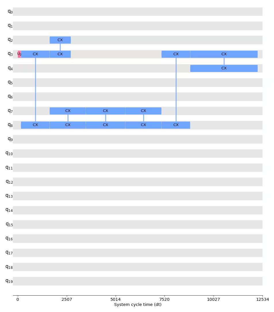

The transpiler inserted Delay instructions to account for idle time on each qubit. To get a better idea of the timing of the circuit we can also look at it with the timeline.draw() function:
timeline.draw() view of the same circuit
Scheduling a circuit involves two parts: analysis and constraint mapping, followed by a padding pass. The first part requires running a scheduling analysis pass (by default this is ALAPSchedulingAnalysis), which analyzes the circuit and records the start time of each instruction in the circuit into a schedule. Once the circuit has an initial schedule, additional passes can be run to account for any timing constraints on the target backend. Finally, a padding pass such as PadDelay or PadDynamicalDecoupling can be executed.
