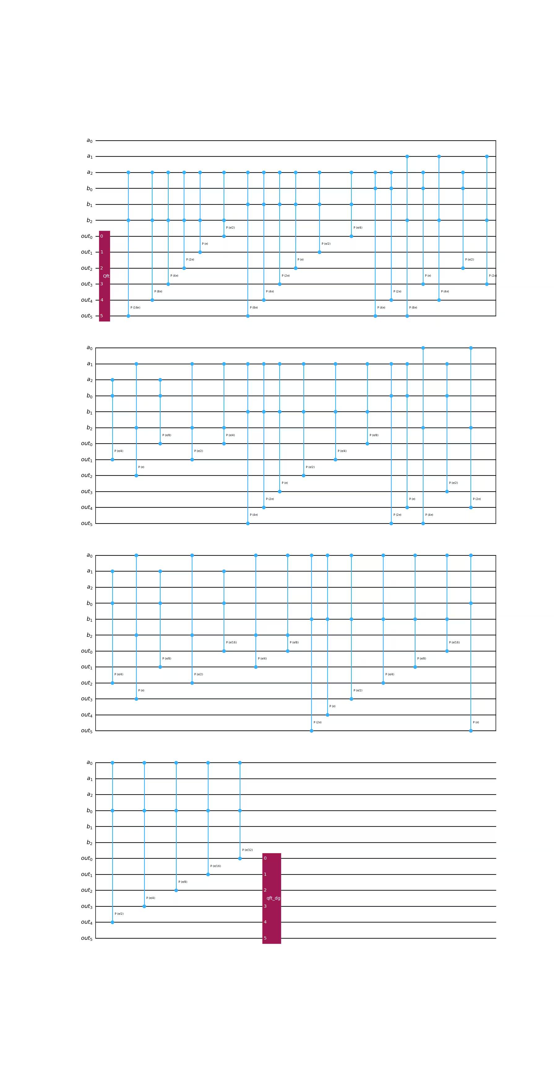

from qiskit.synthesis.arithmetic import multiplier_cumulative_h18
num_state_qubits = 3
circuit = multiplier_cumulative_h18(num_state_qubits)
circuit.draw("mpl")
Multiplication in this circuit is implemented in a classical approach by performing a series of shifted additions using one of the input registers while the qubits from the other input register act as control qubits for the adders.

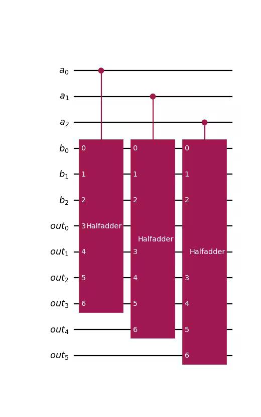

from qiskit.synthesis.arithmetic import multiplier_qft_r17
circuit = multiplier_qft_r17(num_state_qubits)
circuit.draw("mpl")
